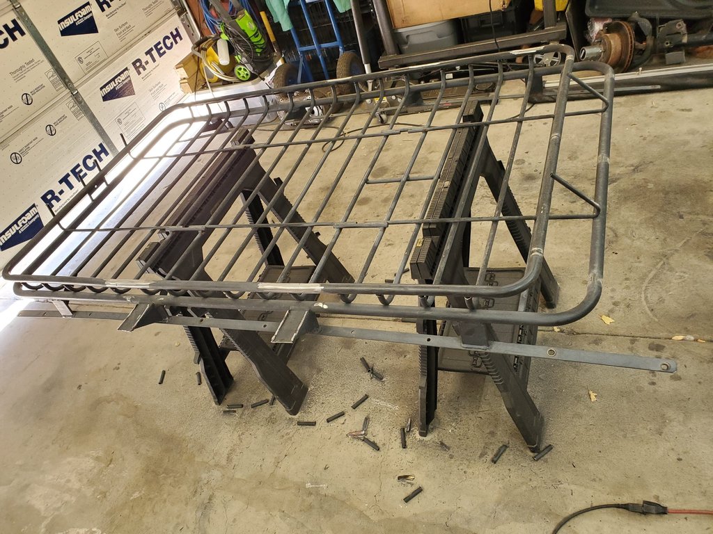

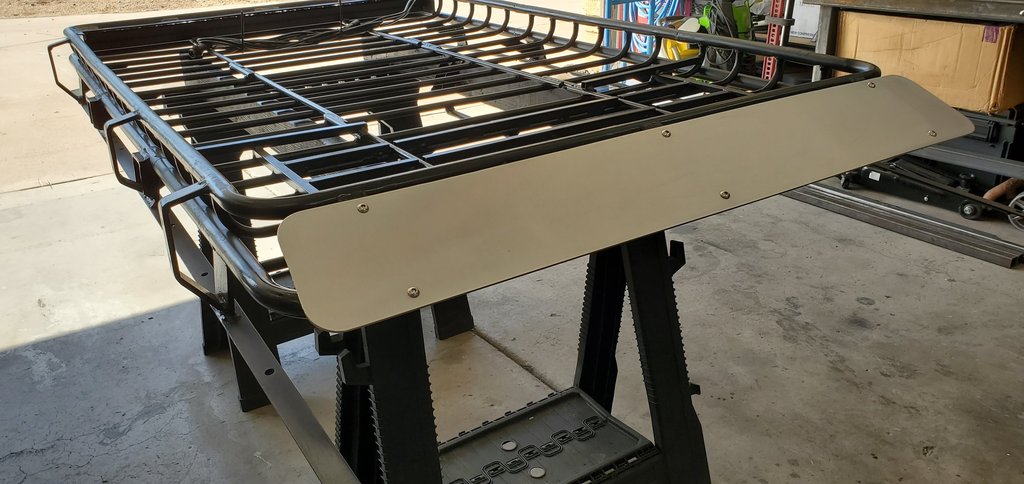

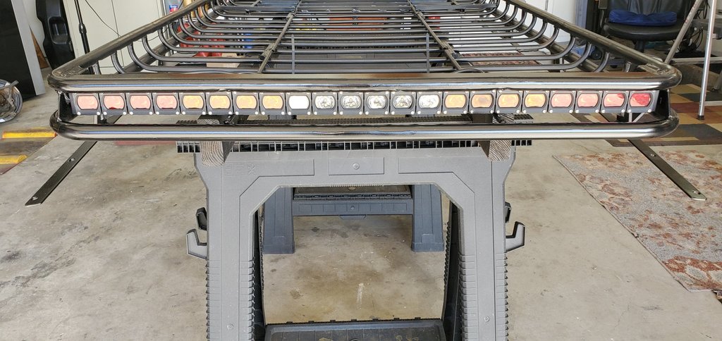

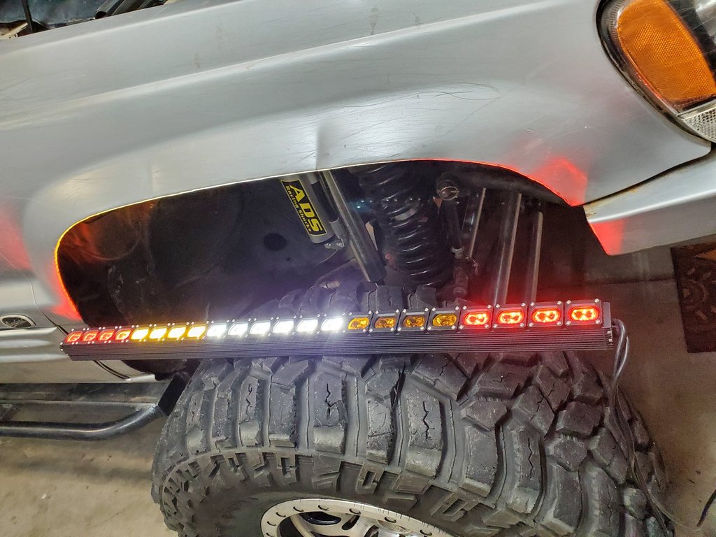

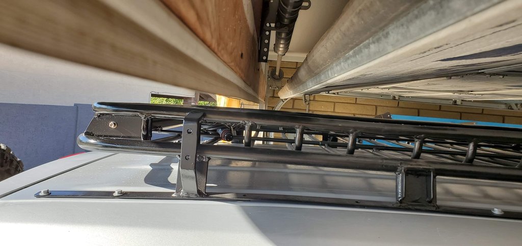

Chris has been busy working on the WJ upgrades.  Our poor girl was parked outside and wanting to go back to her garage princess status.  However we have a very low garage door.  Chris was able to take our roof rack off, cut it in half and re-weld everything back together.  He created a new wind deflector out of aluminum. He also created a place to mount our gas rotopax on top and moved the roof awning to the other side of the Jeep.  Finally, he installed a rear chase bar into the rack.  This was a giant pain int he butt and I would not recommend the Xsprite light bar.  First one we got was not working properly and did a warranty return.  They were good about that but the second one also has issues with the turn signals not working.  But we installed it and just not dealing with another warranty return since everything else functions.  We now have bright LED brake lights and reverse lights as well as optional strobe lights.  Maybe the crazy drivers in Phoenix will be able to see us!   With all of this hard work we can now park her int he garage but it is a very tight fit!!
Rack before:
Cut out about 3":
light bar shot. notice the yellow strobe refusing to work.
new wind deflector and new brackets for the roof awning

Rear view with light bar
Running lights

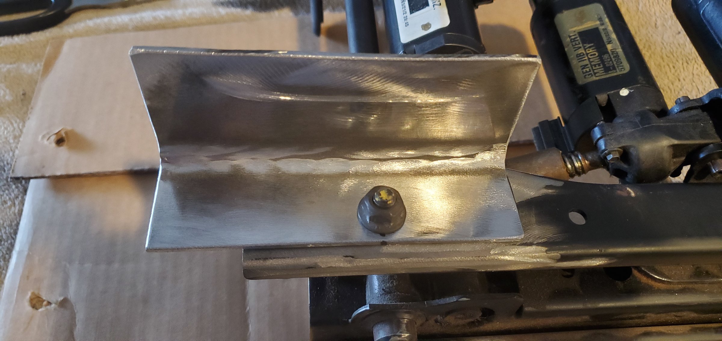

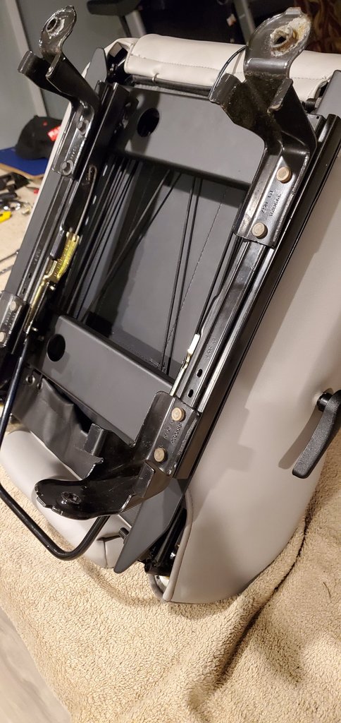

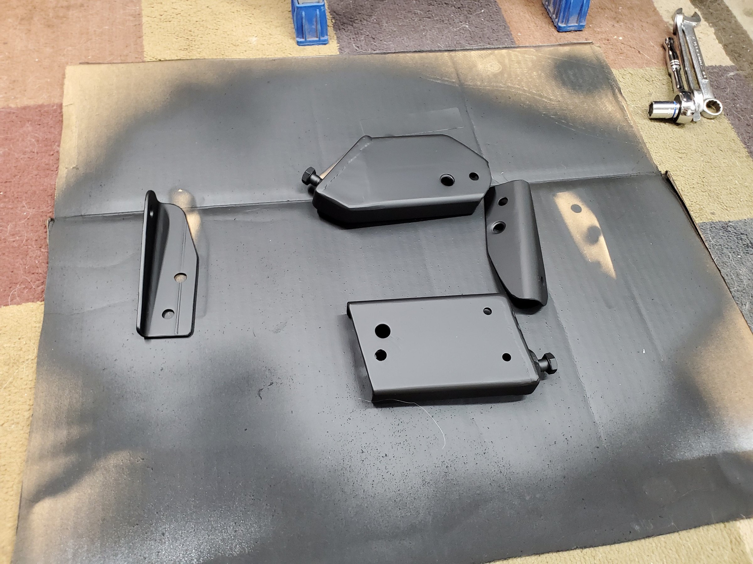

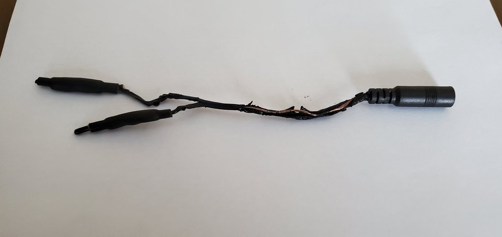

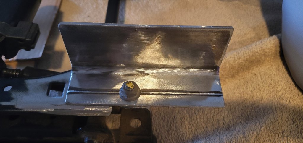

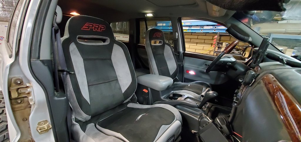

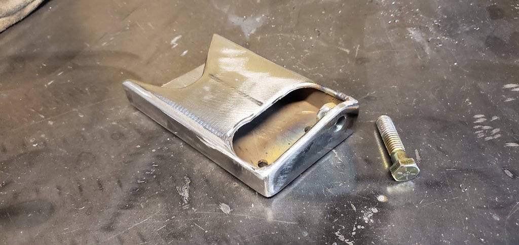

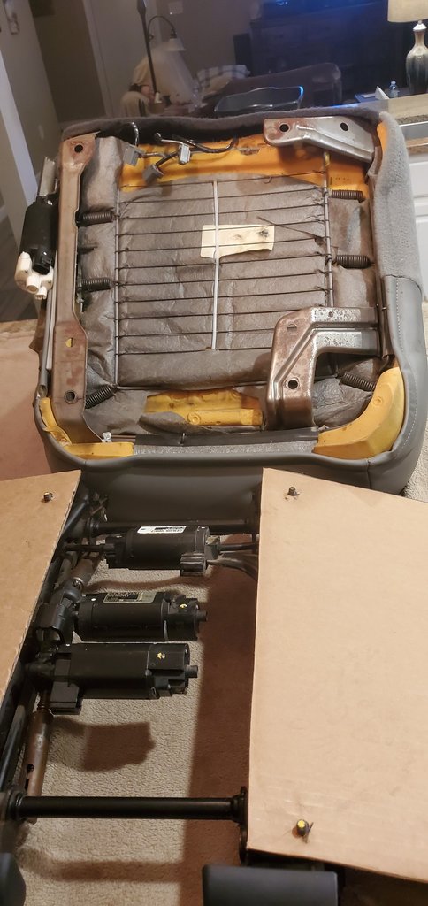

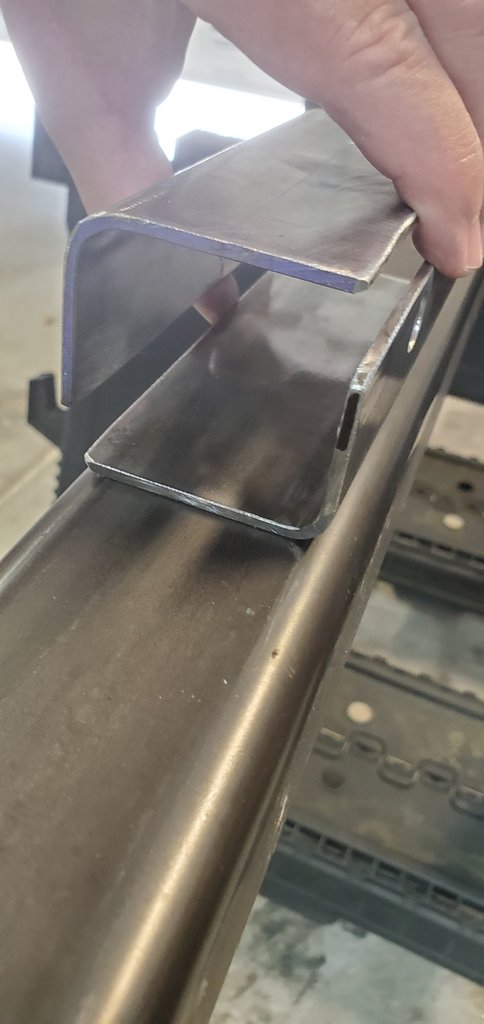

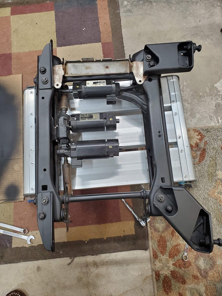

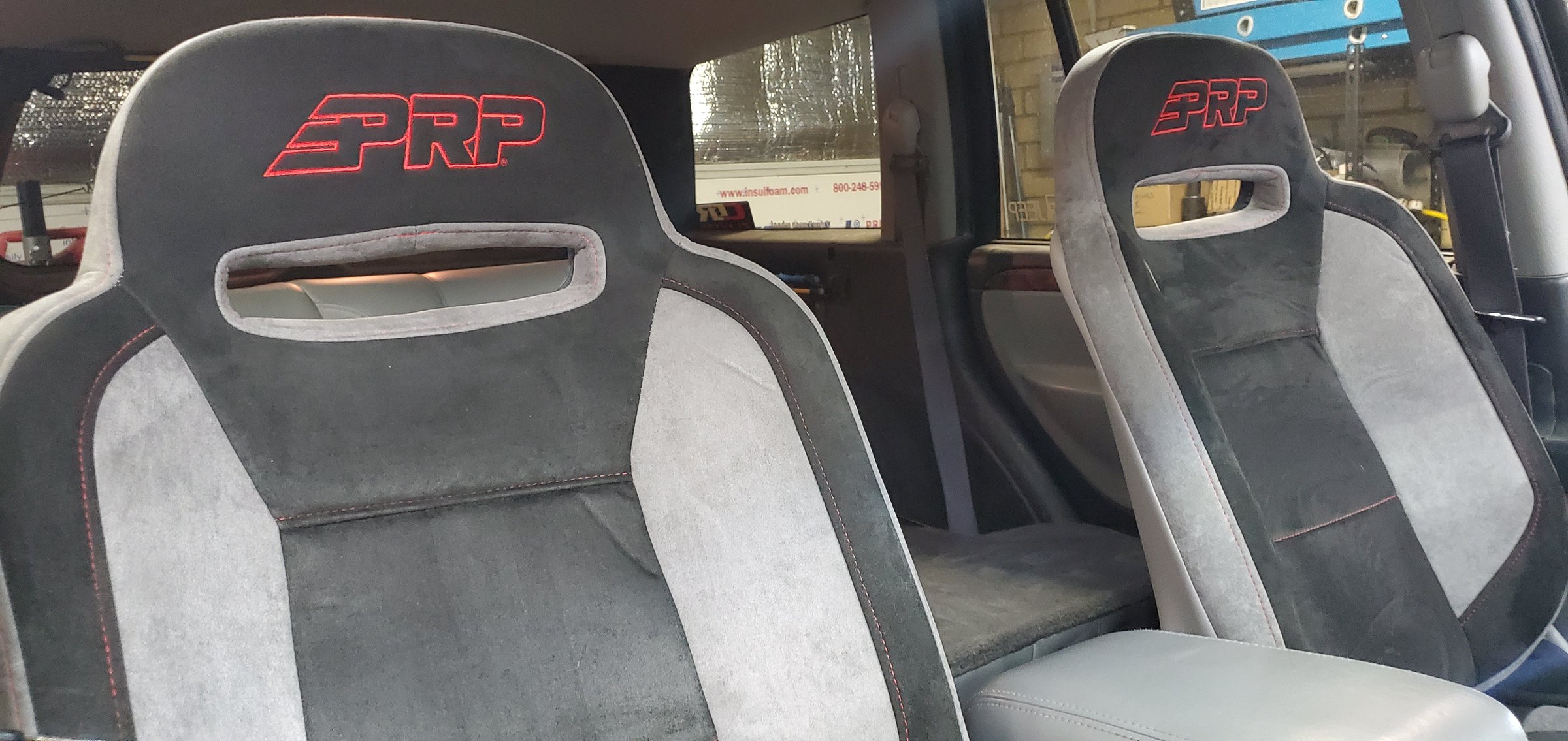

Next project was getting the PRP Eduro Reclining heated seats installed.  We got the low bolster recommendation from several people and are happy went did listen to them!!   We have had these for a year but life got in the way of installing them.  Chris had to completely fabricate new seat pieces to attach to the power base on the driver's side.  For the passenger side we got a manual seat which was slightly easier.  Then Chris and @theksmith were able to figure out how to hack the factory heat switches so we could still use those switches.  Link to those instructions here: Switch Hack    The connector that PRP sent was defective and ended up catching on fire when Chris first went to power the system.  He quickly got the key turned off and no damage was done.  We then had to order new ones and he was able to finish the wiring project without any further issues!  The switches work great and the seat heater is really strong.  The seats only allow for heat on and there is no longer a high and low setting but it's okay with us.   We did get a recommendation, after already buying them, that you could for less money buy seat heater inserts on Amazon.
We got to test ride the seats on a  very long 13+ hours in them for the New year's Day run in Florence.  We are super happy with them.  Our backs actually didn't hurt like they normally do.  Really was just our necks that were sore.  These are very very comfortable and it made a noticeable difference on the bumps and side swaying.  The vehicle felt more stable since our seats weren't flexy and held us in place.  Link to the PRP seats: https://www.prpseats.com/product/enduro-elite-recliner/
Pieces he had to make to get the seat to fit to the WJ base.
With the seat adapters
melted wiring
The culprit that caused all the excitement
Underside of the PRP seat
Base he made
More fun with metal.  You should see the metal shavings pile he had after this project!
Old seat bottom
Another bracket made
Backside of the new seats
Suede comfort

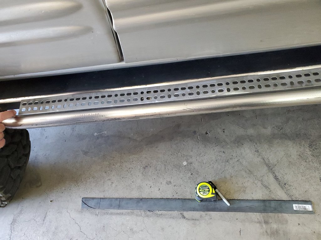

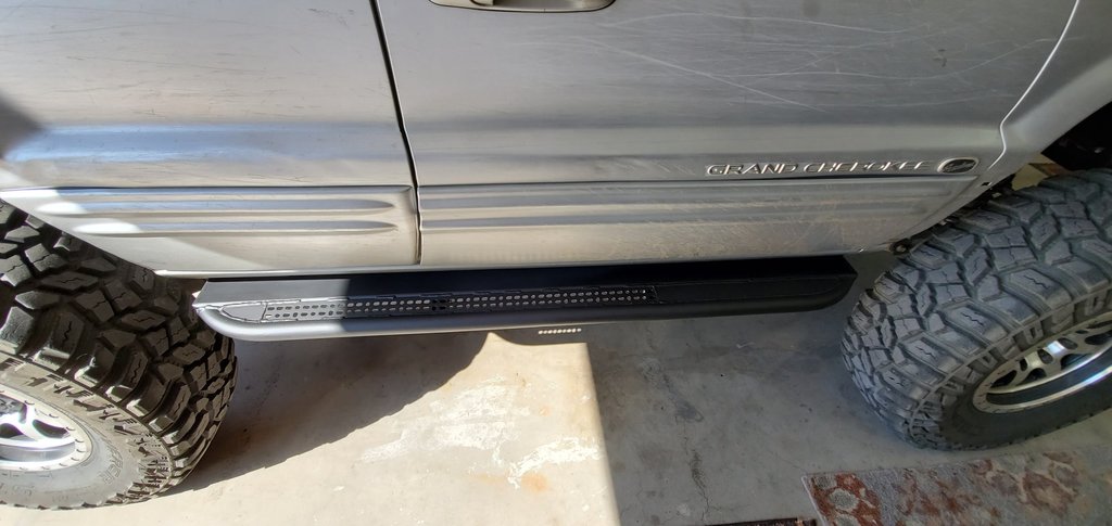

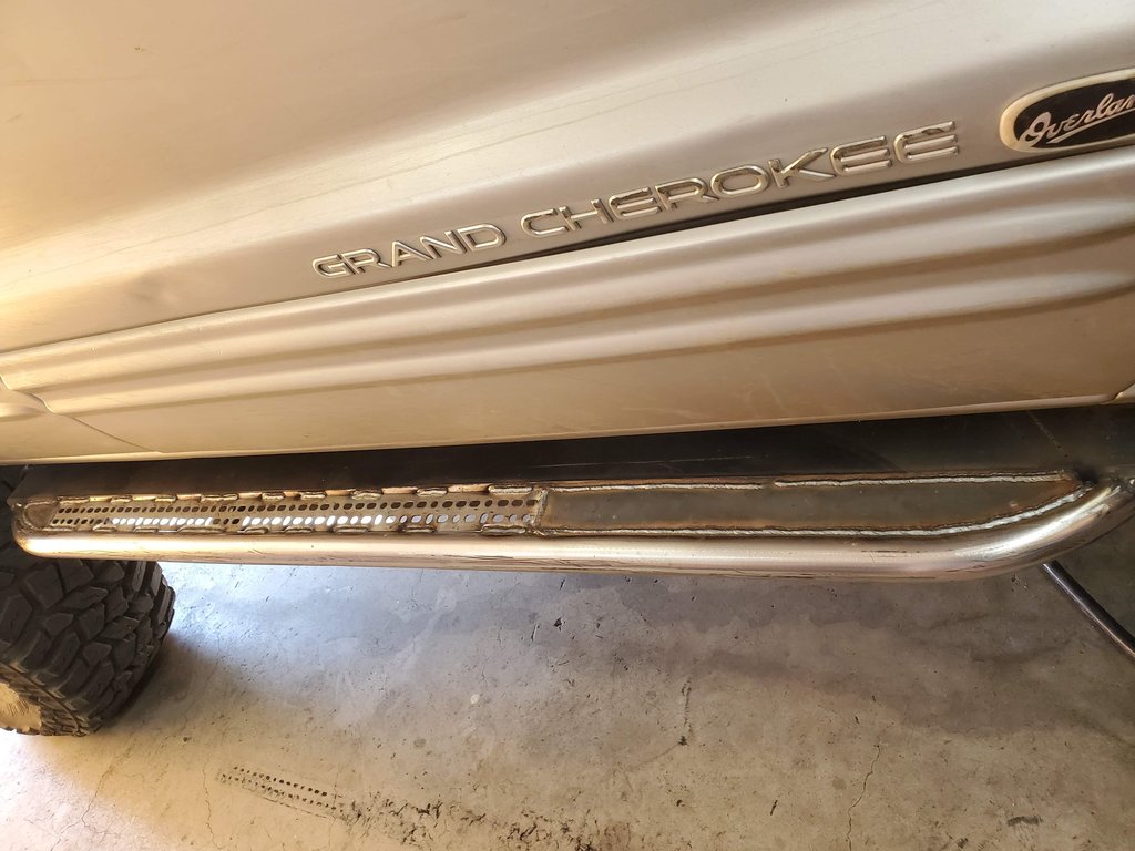

One small project was to modify our rock sliders.  Having the dogs we have been worried about them catching a foot in the sliders when they jumped out of the back seat.  So Chris found some steel at Lowe's that had some holes in to drain any water and provide some grip that fit perfectly in the space we needed.
