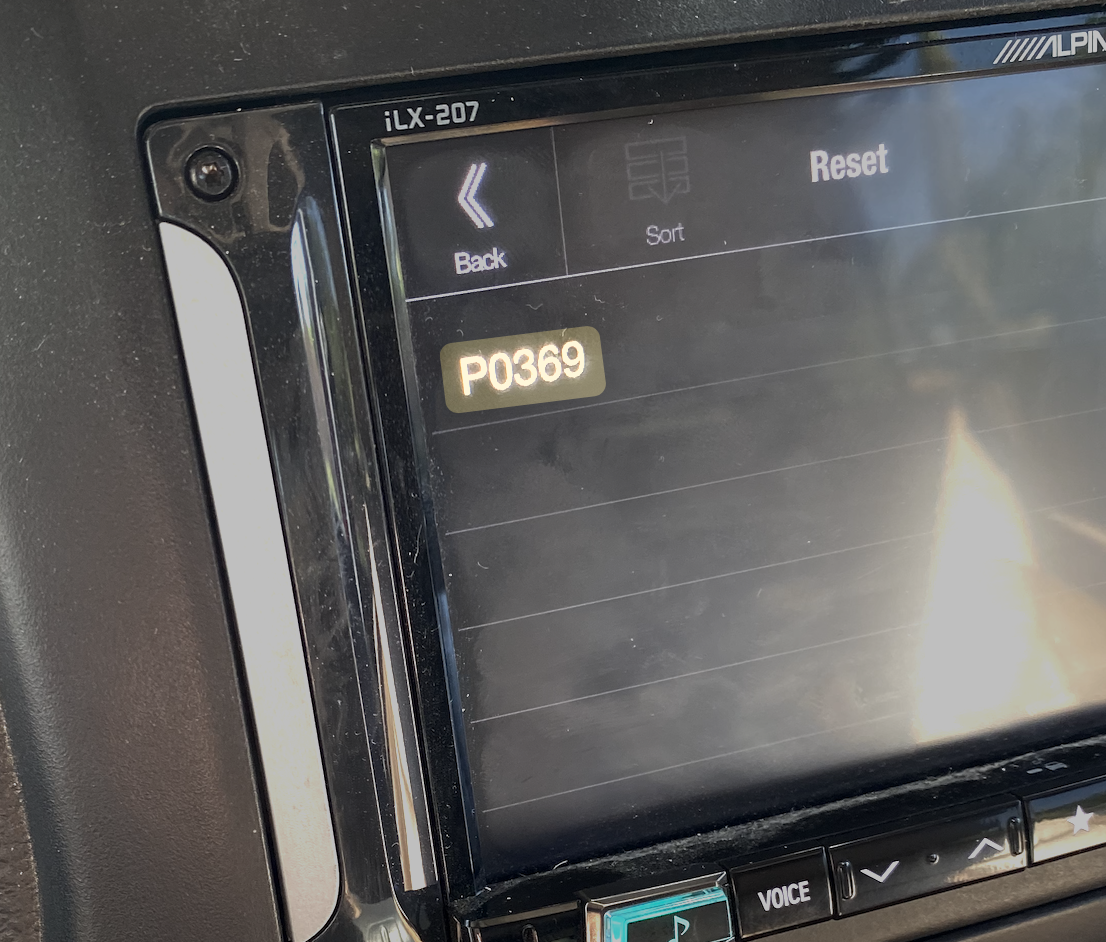

the new engine still seems to run well. however, i have a couple intermittent codes triggering the check-engine light...
one is a P0369 - which is missing signal from one of the camshaft position sensors. from my research, the actual root problem could be electronic or mechanical. the 2 times this triggered the MIL were during extended freeway driving. i re-seated the connector on the sensor and looked/felt around all the engine wiring harness and plugs. i did my first oil-change on the reman engine because that code might also be caused by issues with the cam phasers, which can be finicky about oil viscosity. the oil was really dirty and brown - based on that i'll probably do another early oil change before going to regular intervals. i'm still waiting to see if this code comes back before replacing the sensor.
the other code is a P0430 - which indicates one of the catalytic converters not operating at correct efficiency. Joe at On Point suggested i run the Jeep hard up the freeway to Sunset Point to get the cats really hot and hopefully cook off the coolant that had been dumped on them by the previous engine. i've done that once but the code came back eventually. i'm going to try it again and also run a bottle of CataClean through the system. i have no idea if that cleaner works, but for $25 i'll try it before replacing O2 sensors or the actual $1,400 cat!
i've also been concerned if the Jeep is still running warm. most of the time coolant temps stay around 205* on the freeway and maybe 215* or less with stop and go street driving. however, it randomly still spikes up into the 220's and even occasionally hits 230 on the street. it never seem to go over 230 because the fan kicks up a notch and cools it right down. i honestly am not sure if this is totally normal for the 3.6L and i've just never watched it like a hawk before under normal conditions. i do remember that even when the Jeep was new, it was not uncommon to see it in the 220's and even go above 230* on a long hill climb - but i don't recall see it hit 230* randomly in cool weather just driving around town. most of the cooling system is new or less than a year old and 95% OEM parts, so i'm not sure what to do about this other than see how it acts when summer temps come.

That was the same code I used to fight. Checked wires, sensor, tighten the screws on the back of the cam valves (whatever are called, but according to some forums those were causing problems for some), everything. The code only came on once in a blue moon, the Jeep went in limp mode, had to clear the DTC, and all would be normal.
In the end I think that it was all due to the AMOIL viscosity I was using. I forgot what grade it was, it was whatever their site recommend, but it was different than the OEM rec. Once I switch to OEM spec and MobileONE never had that code again.
