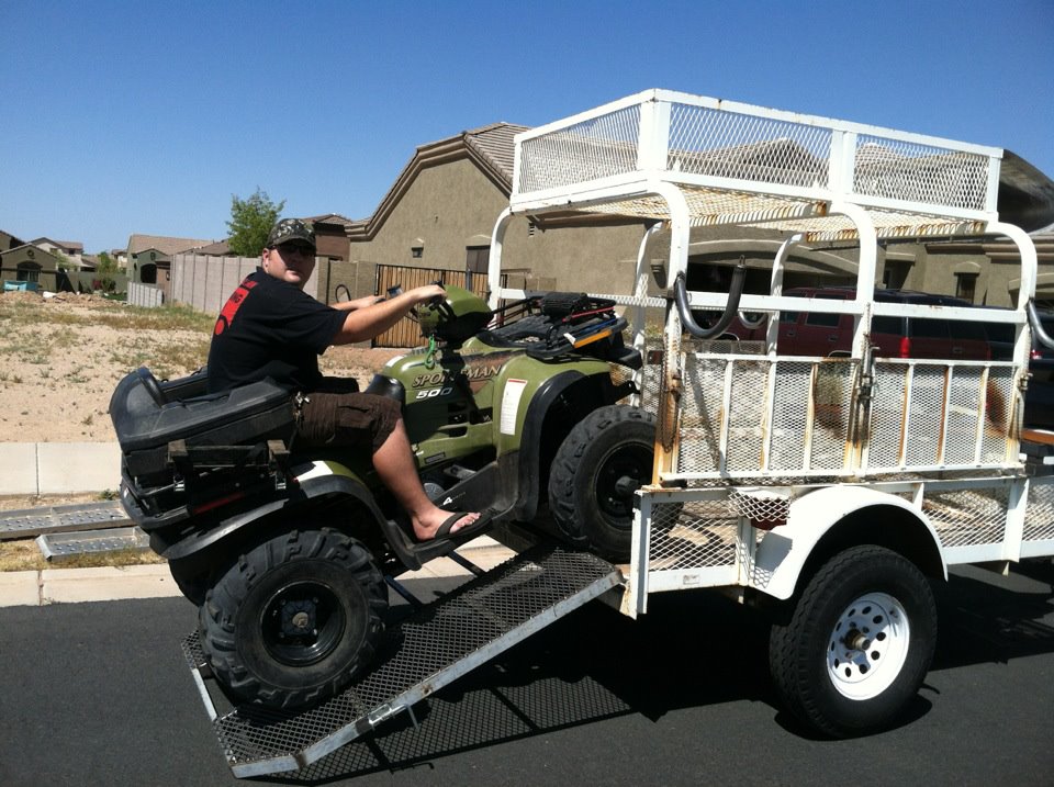

Its a tight fit when you drive the quad under, and its going to be even tighter when its right at the top of the ramps. Plus its just going to be a "spacer" lift with 2x4 steel tubing that's only going to get tacked for a bit of peace of mind, so if I notice an unsafe difference it will be easily removable with a grinder and wrenches. The upper rack won't see much added weight as it is mostly going to be used for light gear such as: sleeping bags, tents, cot pads, canopies, the "camp throne" and other light items. Plus the weight of the quad, gas cans, coolers, the 35 gallon water tank, firewood and other bulky items on the deck will help keep the COG low. Right now she tows easily and corners with ease, so hopefully that wont change too much with the lift.

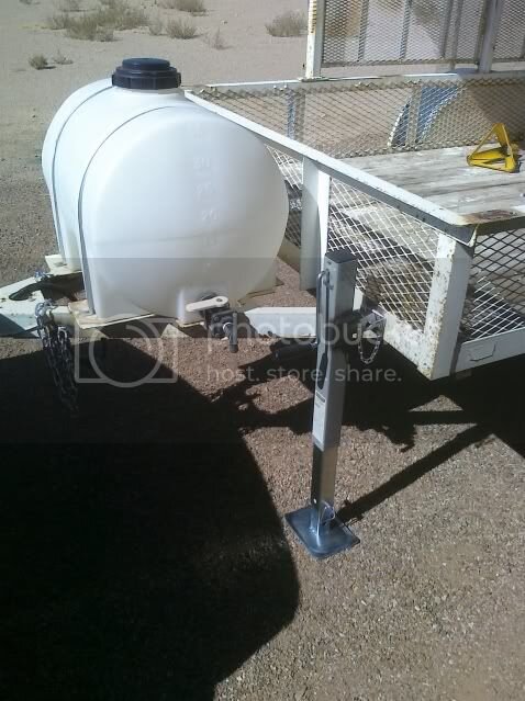

New 3500 lb trailer jack, old one self destructed. lol.
Old jack mounting location, future jerry can mounting location,

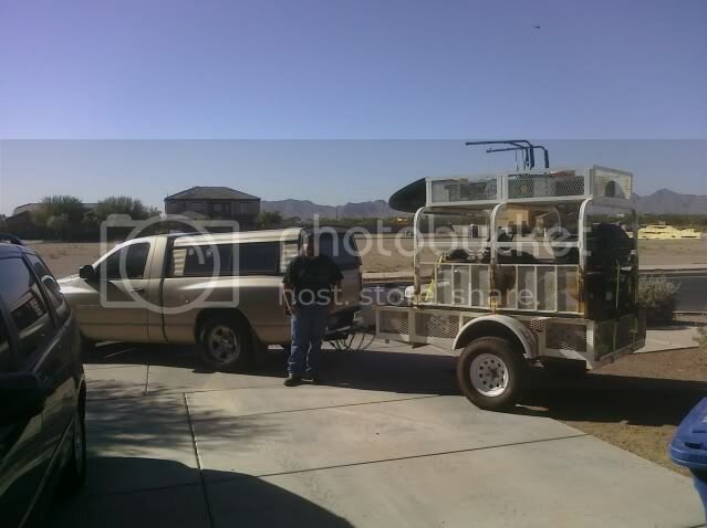

Leaving for camp:

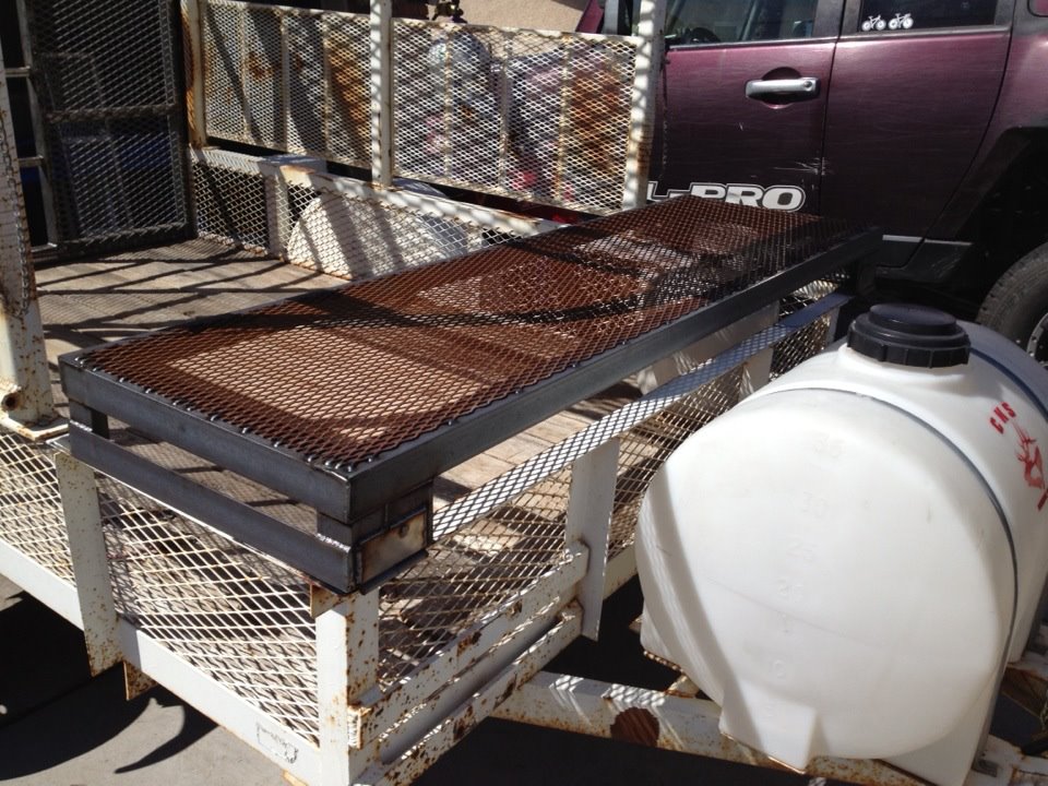

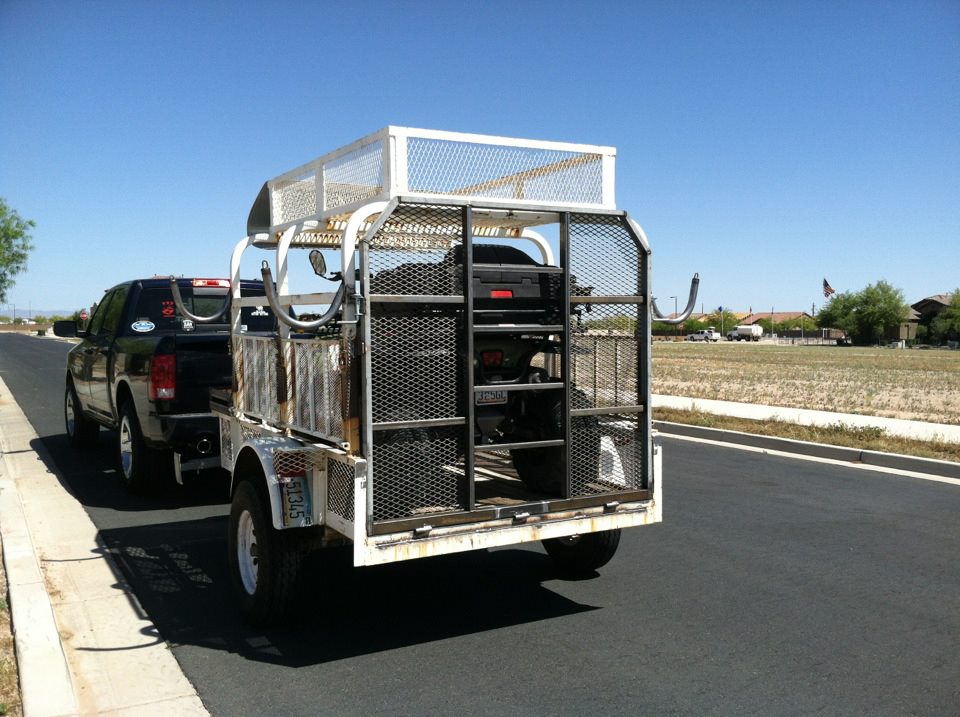

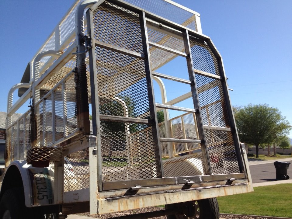

Just picked up the trailer from Jeff-JWFAB, had to share all the amazing work he did. Added a new removable ramp with ladder, added a removable cooler shelf that my gas cans and propane cans can be stored under, added kayak racks to both sides and fixed my tables so the can drop down and be used again.
New cooler shelf:
New ramp with ladder:

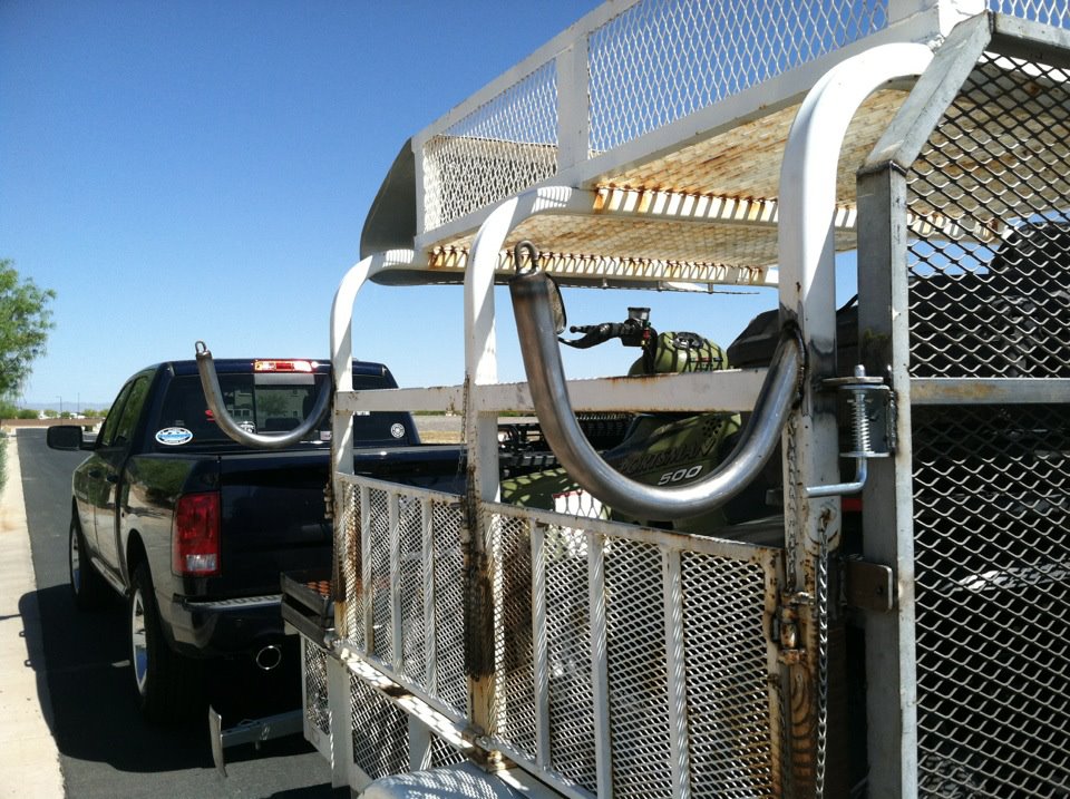

Kayak racks:

VERY BIG THANKS TO JEFF :yourock: I highly recommend Jeffs work, and will continue to do business with him. We will be installing slider steps on my truck tomorrow and he will be doing a full custom front winch bumper with grill guard, can't wait to get that project started.
very nice! having something done custom so it's exactly the way you need it is the way to go when you can.
one thing - maybe i'm overly paranoid, but i'd add a piece of flat stock running vertical between the bottom inside of the kayak hoops and the uprights as a gusset... or else a small tube brace coming from the bottoms down at an angle would even be stronger and less wind resistance maybe.
