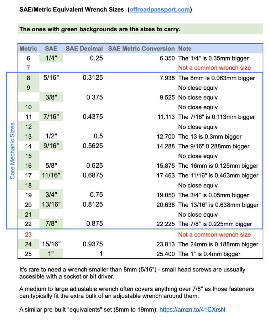

theksmith 5,816 Posted August 5 i put this together to see what wrenches i could get away with eliminating from my rig's emergency tool roll (for weight/bulk savings)... so if you carry only the green "close enough sizes" shown above, and only the most common "core mechanic" sizes, you can carry 16 wrenches instead of 25 and be covered for most field repairs. link to a similar prebuilt set... thoughts? find any errors? of course if you have an import rig you only need metric wrenches, but many middle-aged American rigs are a mix of metric and SAE. does anyone know - are the latest JL's and JT's 100% metric yet? 1 Share this post Link to post Share on other sites

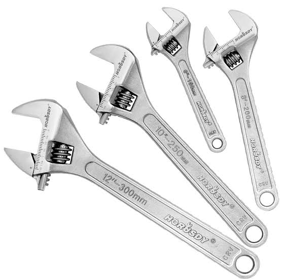

Curly 1,319 Posted August 5 Hey Kristopher, Have you ever heard of these? 4 Share this post Link to post Share on other sites
theksmith 5,816 Posted August 5 1 minute ago, Curly said: Hey Kristopher, Have you ever heard of these? if the Jeep engineers had left enough space for those around most of the bolt heads then they would have never invented combination wrenches! Share this post Link to post Share on other sites
Curly 1,319 Posted August 10 Don't forget to pack a set of these! 4 Share this post Link to post Share on other sites
ob1jeeper 855 Posted August 14 On 8/5/2026 at 7:46 AM, theksmith said: i put this together to see what wrenches i could get away with eliminating from my rig's emergency tool roll (for weight/bulk savings)... so if you carry only the green "close enough sizes" shown above, and only the most common "core mechanic" sizes, you can carry 16 wrenches instead of 25 and be covered for most field repairs. link to a similar prebuilt set... thoughts? find any errors? of course if you have an import rig you only need metric wrenches, but many middle-aged American rigs are a mix of metric and SAE. does anyone know - are the latest JL's and JT's 100% metric yet? Handy list for sure Kris... Well done & Thanks for the reminder to do the same for my own traveling tool bag... ;) 1 Share this post Link to post Share on other sites
