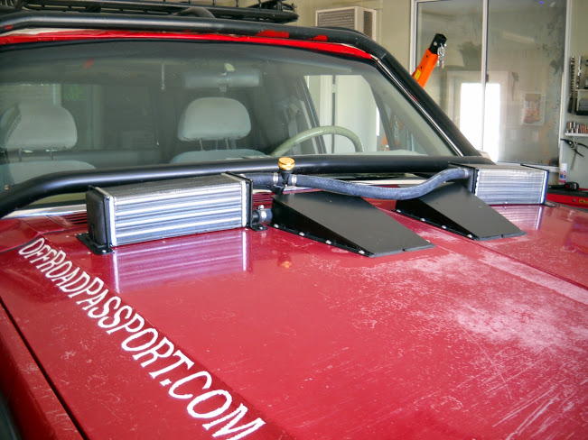

Clifford's getting his ECCM reinstalled today. #extracoolingcapacitymod #itsanXJthing
KEWL! Or, as OB1jeeper often says, "cool beans!"
