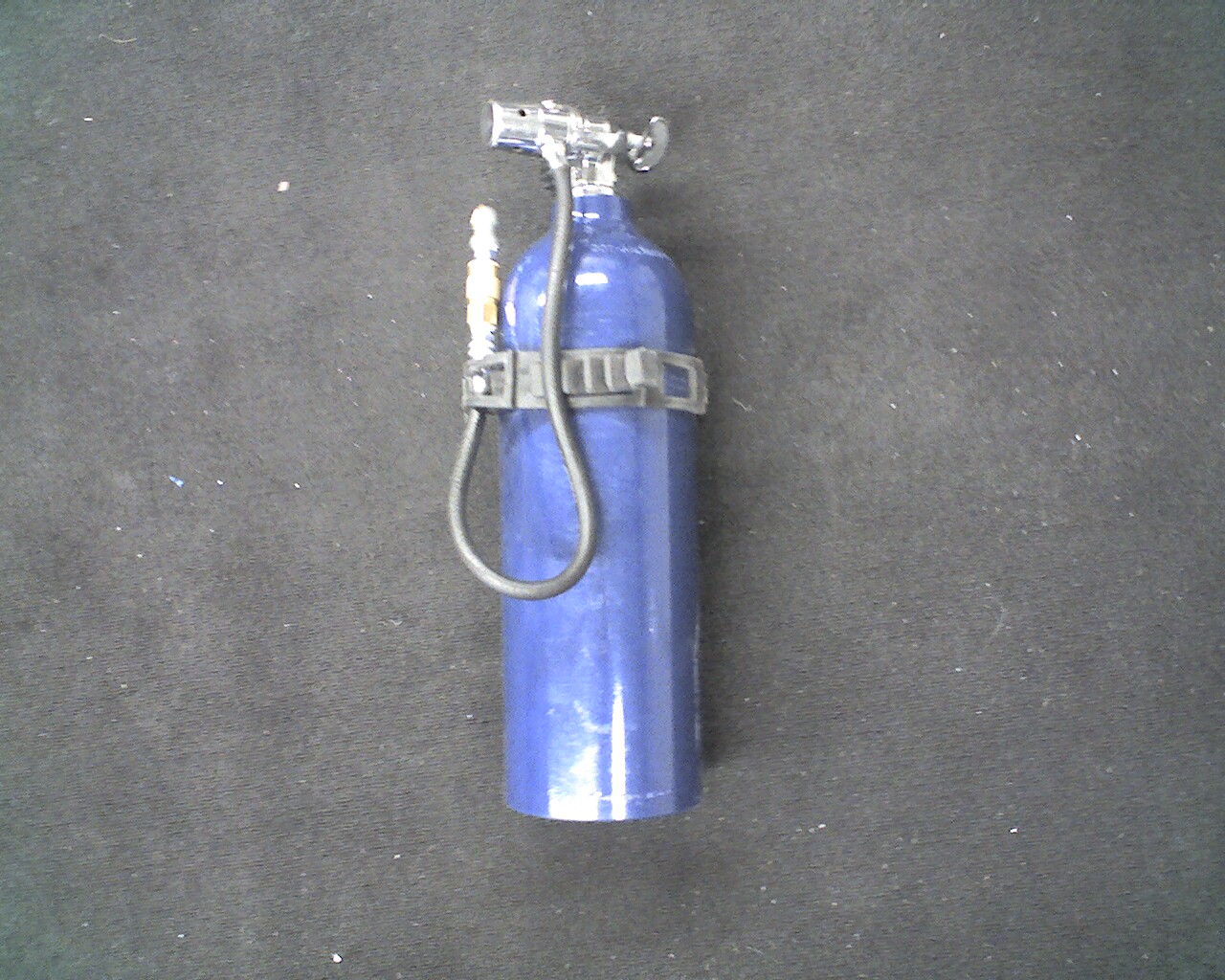

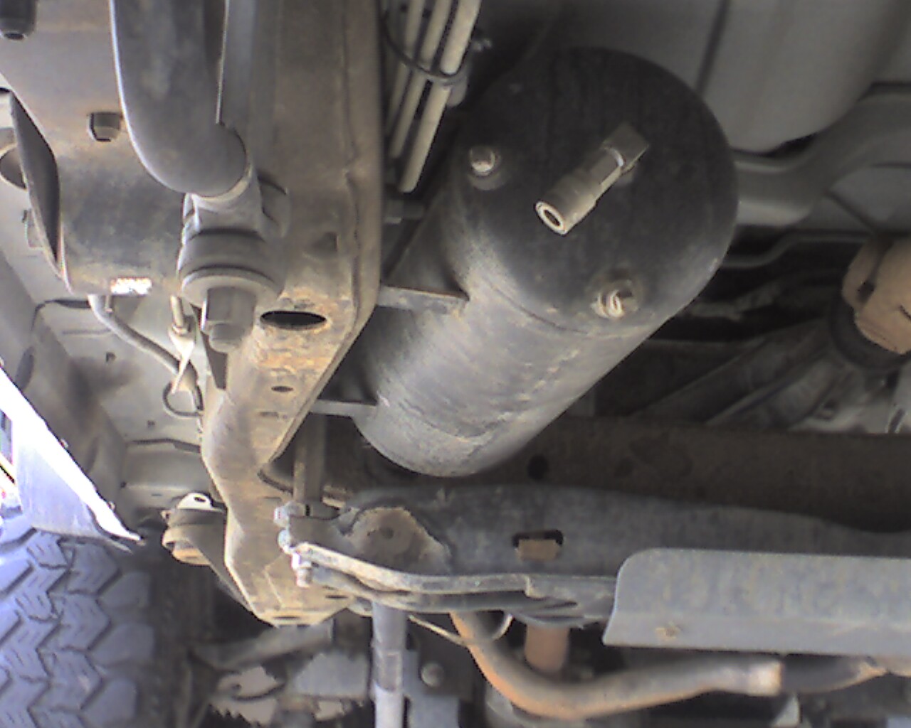

ducksface 2 Posted January 16, 2011 I went a bit of a different route. I have a little bitty, mostly useless ARB 1cfm compressor set at 125psi. The tank and the compressor are under the truck. I carry a scuba tank with me and use the under truck tank as an expansion tank. I can get [in theory] 10 full fills on 35's and the air to use the air tools to do it. I have posted this in answer to the 'will it take the heat' question. Mine is under the truck, tank and compressor, and has has no problems in Lake Havasu [two summers] and Death Valley[same temps and dust as Lake Havasu]. Share this post Link to post Share on other sites
