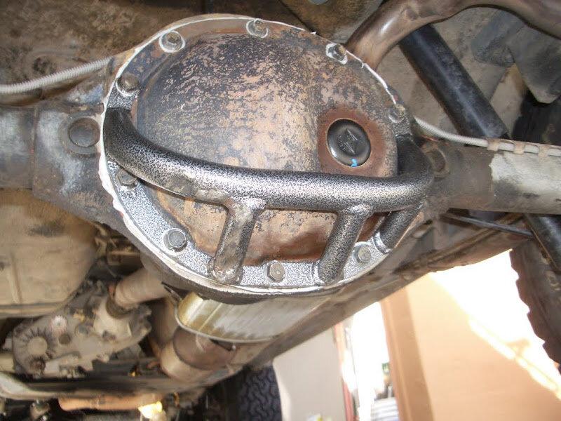

Got a few things done today. Virgil (K7AZV) gave me a diff. guard for my Dana 35 & George installed it. So now if I lame out and totally back into something it'll probably be okay. Thanks Virgil!

Here's where I put those dents in the diff guard. Rattlesnake Canyon - Memorial Day 2009.
