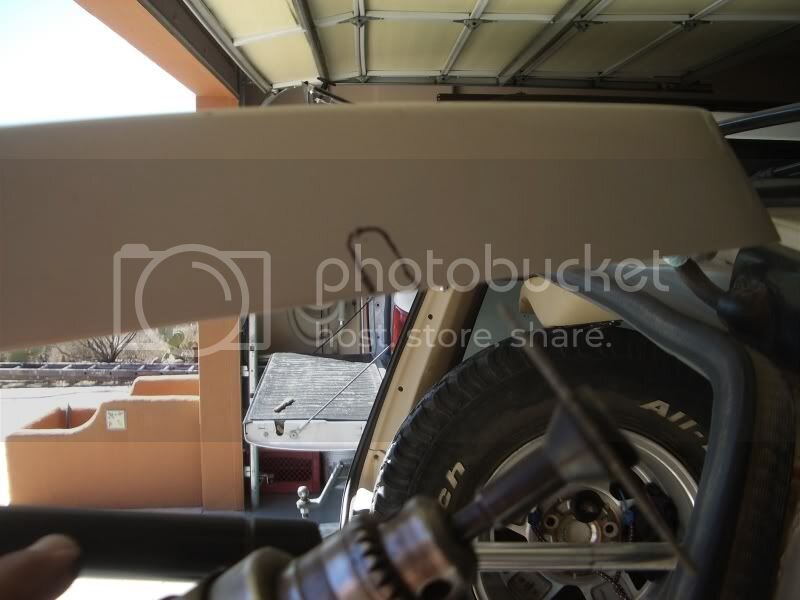

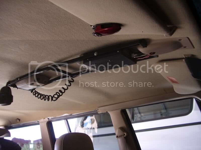

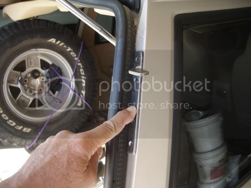

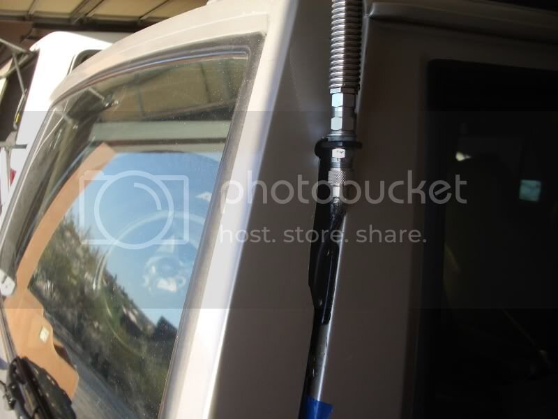

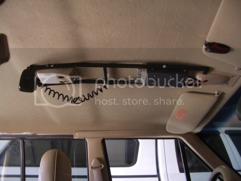

dzJeepChic 2,897 Posted November 5, 2009 Here's an update on -e!'s progress. Who wants to see my new rack? George got it in exchange for one of his CB Mounts for a TJ, fabbed it to fit the factory rails, painted it black, and viola! Next he worked on developing a CB Mount for -e! It came out sweet! He found a bracket on the donor vehicle that fit under the dome light and used it to attach the rear. The front mount is hidden by the factory cover for the remote lock sensor, which we didn't receive with the vehicle, so he gutted it out. Then he fabbed an antenna mount for the rear hatch: Custom Hatch Trim Job: He had to do some major grinding on the mount and cut a section of the cable connector off to make it fit: Finished product: We tested the CB yesterday and it worked great! He went all the way down to the nearest intersection in -e!, and I could still hear him from Number 7 inside the garage! Can't wait for the next trail ride! d Share this post Link to post Share on other sites

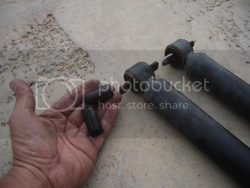

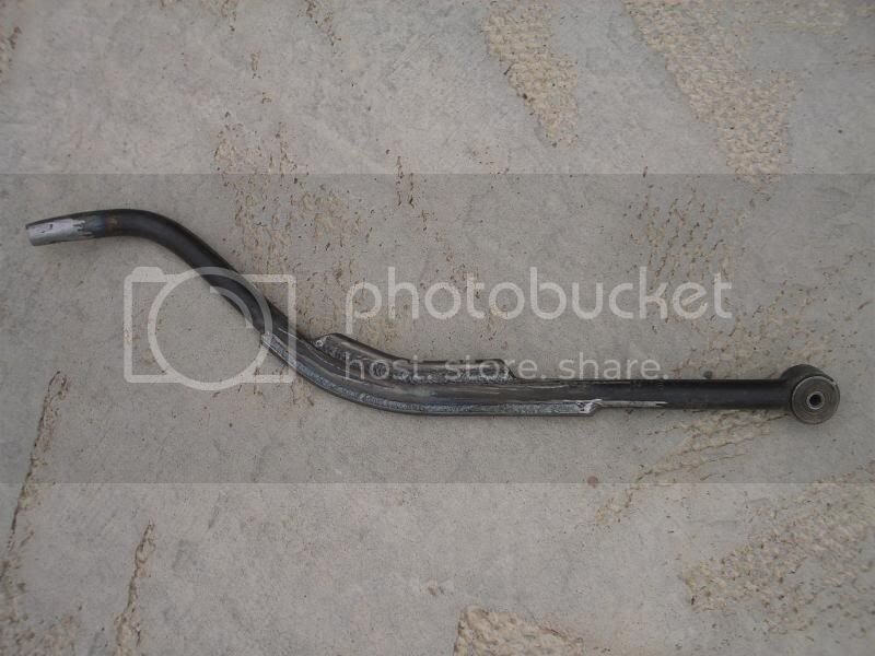

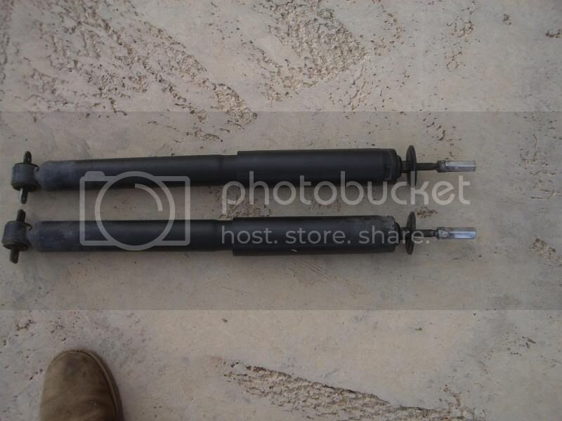

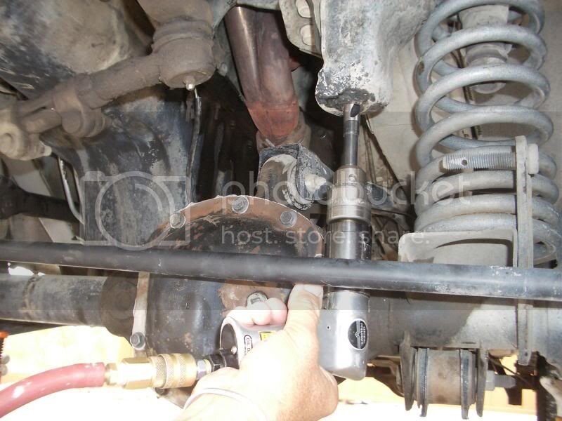

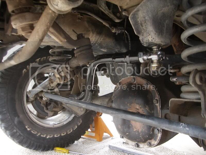

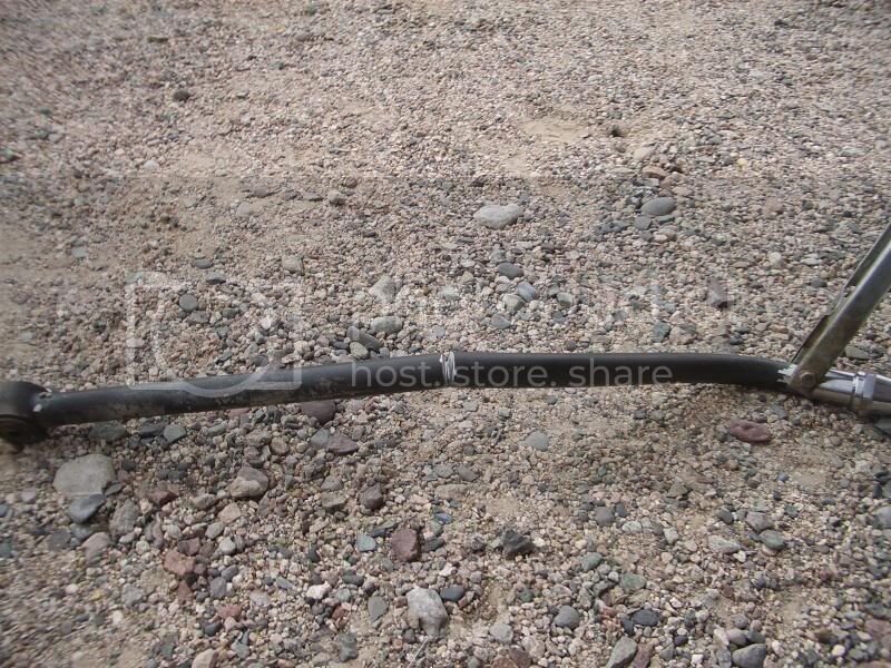

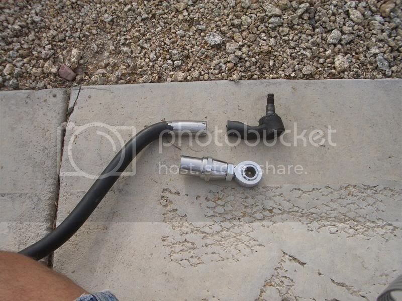

dzJeepChic 2,897 Posted November 14, 2009 We picked up Grunt's 3" Pro-Comp lift kit parts for -e!. The first thing George did was take apart the leaf packs. One bushing was off-center, so he took the original leaf packs off of –e!, and just used Grunt’s add-a-leafs. The factory leaf packs have nylon sliders on the ends, so George added those to the add-a-leafs too, to reduce the friction. He also eliminated the very bottom short leaf. The install was easy, he used the factory u-bolts and shackles. George already knew that the track bar would be too short when he jacked up the front-end to install the new springs. He pulled it, cut the ball joint off the end, cut and bent it up in the middle for proper alignment with the drag link, and then installed an adjustable heim joint in place of the original ball joint. This should eliminate bump-steer. Cut and bend: Reinforcement: Drilled out the ball-joint hole to 5/8” with my new $23 drill bit, a bit pricy, but it cut like buttah: Finished product with springs installed: We used the complete set of factory shocks Goose gave us off his JK. The fronts were too short, so here’s George’s shock-extension idea he’s trying. He had to remove the sleeves and install bar-pins in the front; discovered a super easy way to do that. He heated the metal part not allowing the flame to touch the rubber, and it slid right out. Then he heated the bar-pins, and they slid right in. He cooled it with water, and when they cooled they glued in tight. Next, he relocated the brake lines: Continued V V V Share this post Link to post Share on other sites

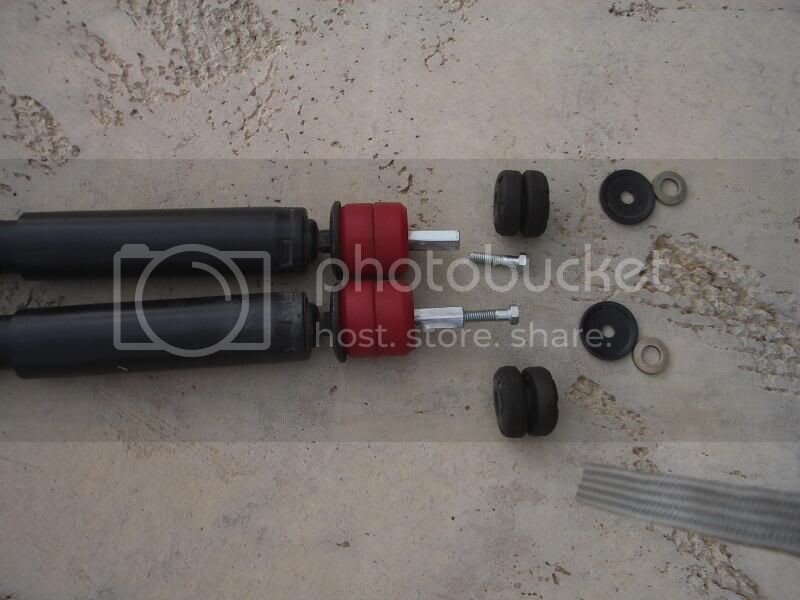

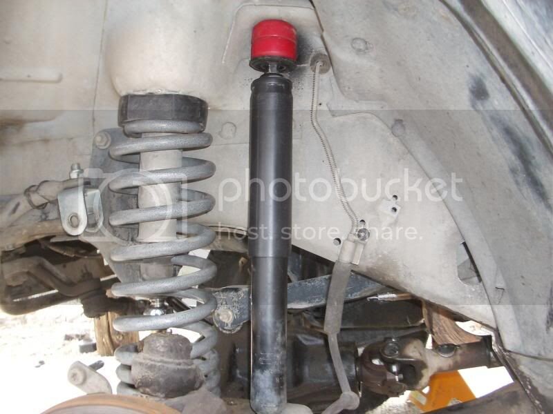

dzJeepChic 2,897 Posted November 14, 2009 He removed the factory spring isolators and put in 1” Rocky Mountain isolators that thekdude gave us. Here’s the front shock extension; he bumped it up with Body Mount pucks he had laying around: Top of the shock: Here she is. She actually only gained 2” in the back and 1.5” in front since we removed the bump kit we’d installed: Today: alignment, straighten steering wheel and check bolts. Still waiting for our lower control arms; they’re getting ballistic joints installed. Almost ready to roll. Thanks Everybody for the Free and Smoking Deal Stuff! Share this post Link to post Share on other sites
