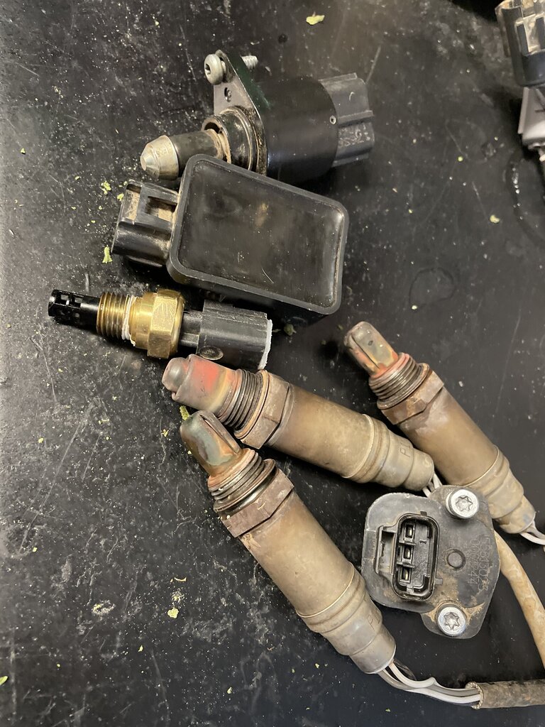

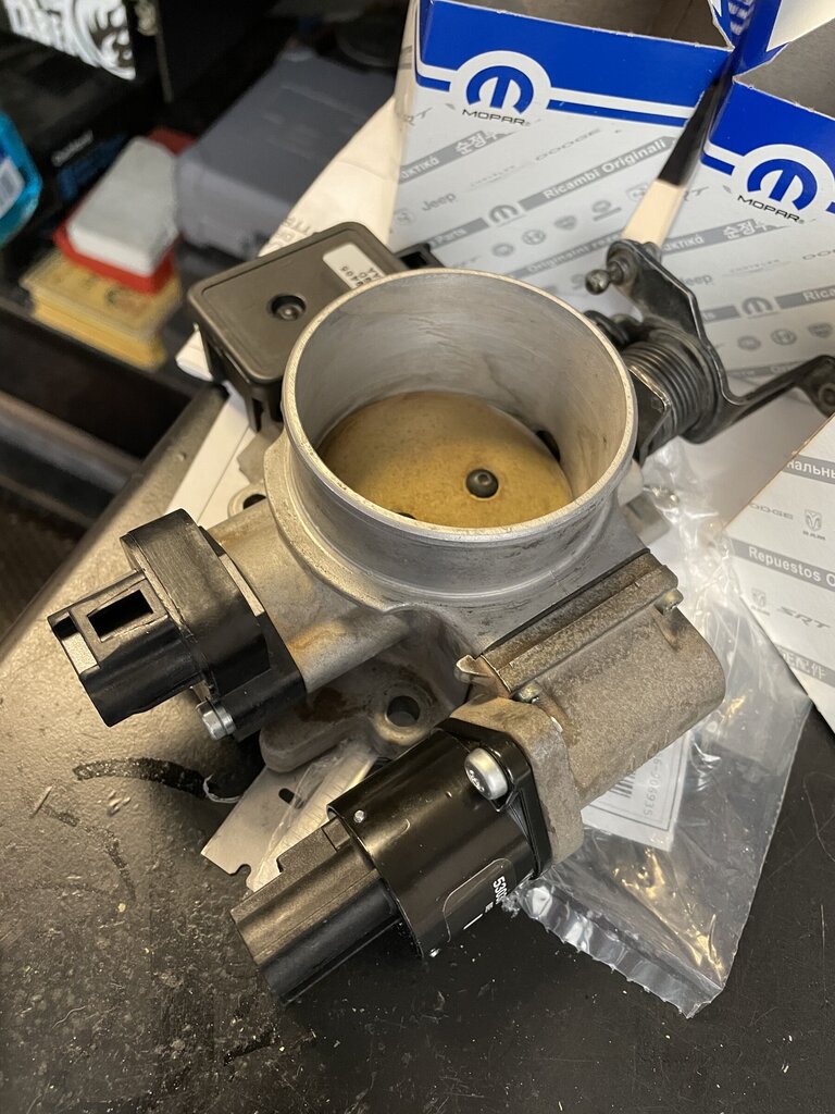

scottL 185 Posted March 23, 2021 Still hard start & rough idle, 250rpm or less. This old Jeep needs love Removed TB again replaced all intake sensors with MOPA units replaced o2 sensors then bank 2 sensor welded itself to my manifold from constant heat cycles over a decade great.. 1 Share this post Link to post Share on other sites

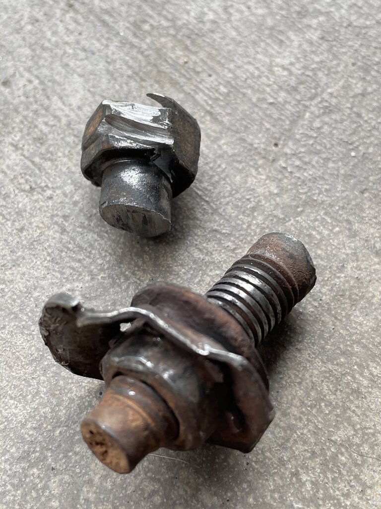

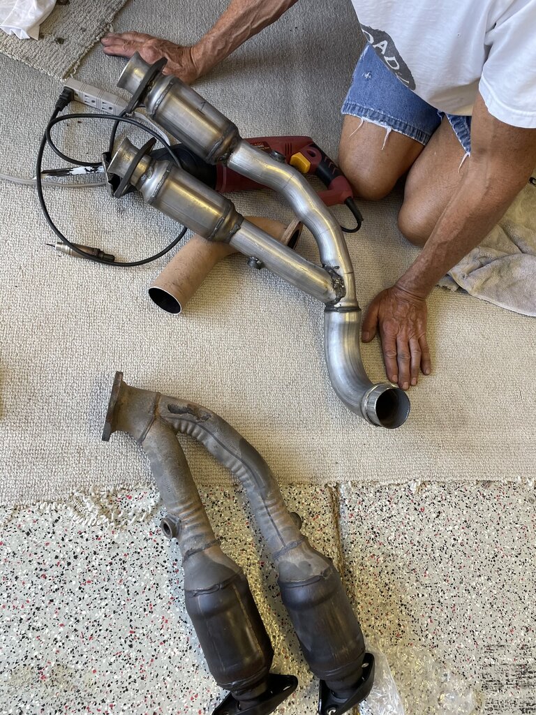

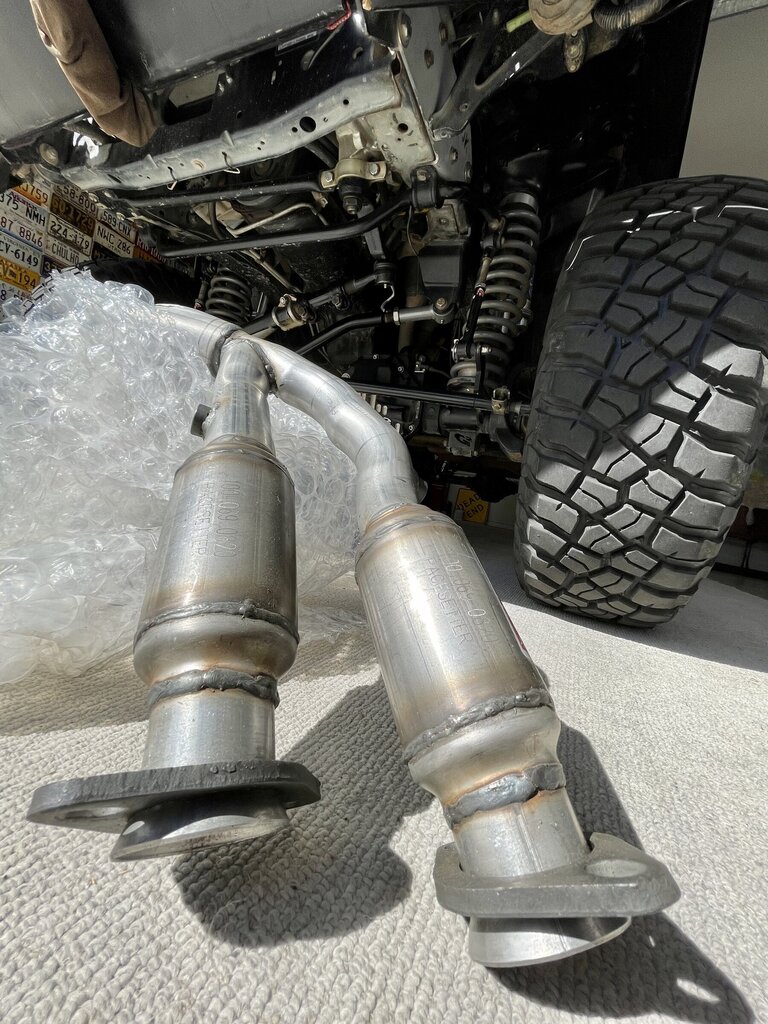

scottL 185 Posted March 23, 2021 ..did some horse trading with @Number7 for a new 2.5” manifold back Frankexhaust system & got this replacement flangeless precat pipe from Pacesetter, which are made here in Phoenix Arizona flange on the previous Walker unit would rub against my driveshaft at full stuff you can see where the yoke made contact nearly smashing a hole in it at one point Fun fact: took me, G & theK 3+ hours to get this 1 bolt off 2 Share this post Link to post Share on other sites
