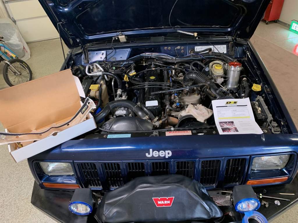

Jeep Fuel Rail and Injector cover kit arrived yesterday
010378-JeepFuelRailKit-Package-Front__38127.1497280156.jpg?c=2&imbypass=on
Kit covers all the bases
010378-JeepFuelRailKit-Front__84132.1497280157.jpg?c=2&imbypass=on
Time to get to work

First, get a fuel rag ready and relieve fuel pressure at the Schrader valve then disconnect the fuel rail.. I used this quick disconnect tool purchased at Vatozone for $11 (gray one works for XJ's)

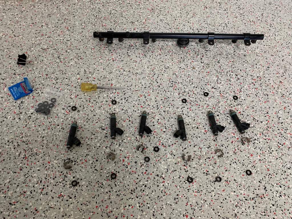

After removing my throttle, cruise control and transmission kick down cables, the instructions say to tape and number your injectors which I'm glad I did
Factory injector O rings were crusty so good timing to lube up the supplied new ones and pop them on. Resprayed my fuel rail in semi gloss black even though I know it's gonna get covered up soon

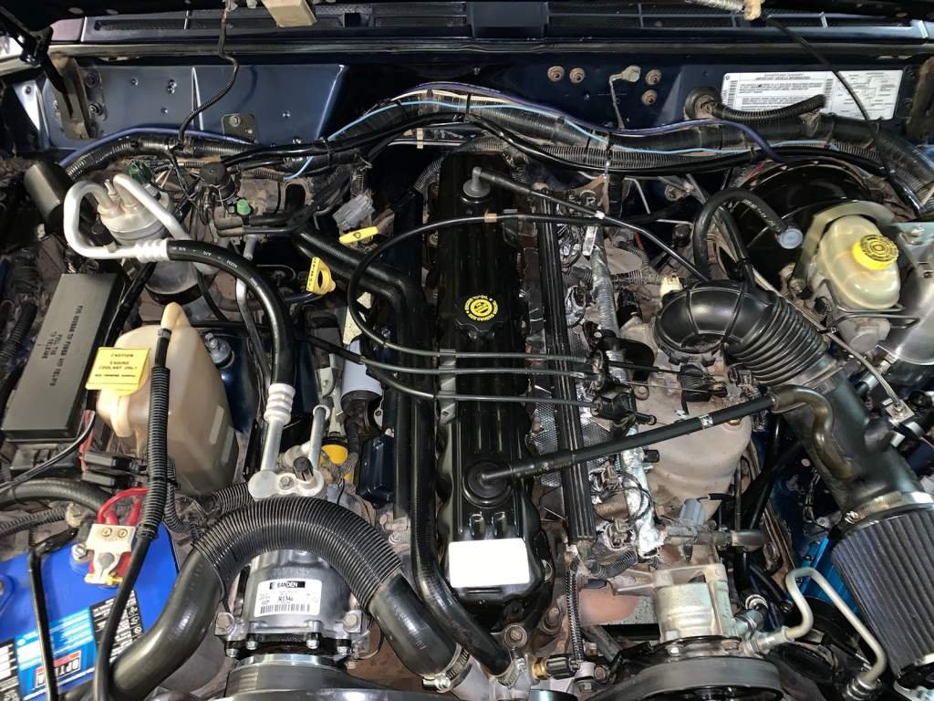

Wrapped the fuel rail and injectors then reinstalled back in to the intake with plenty of lube. All but one of the plug retainers broke off on removal from endless heat cycling but they went back in snug so keeping my fingers crossed.. I'll get a new injector harness when upgrading to 4 hole injectors soon
All buttoned up and ready to roll
Took a quick trip to the 101 and got the Jeep up to 75mph with no fuel leaks. The real test will be a hot restart out on the trail.. hopefully this solves my fuel vaporization issue.
