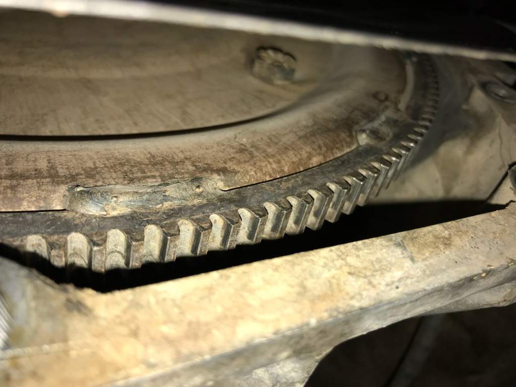

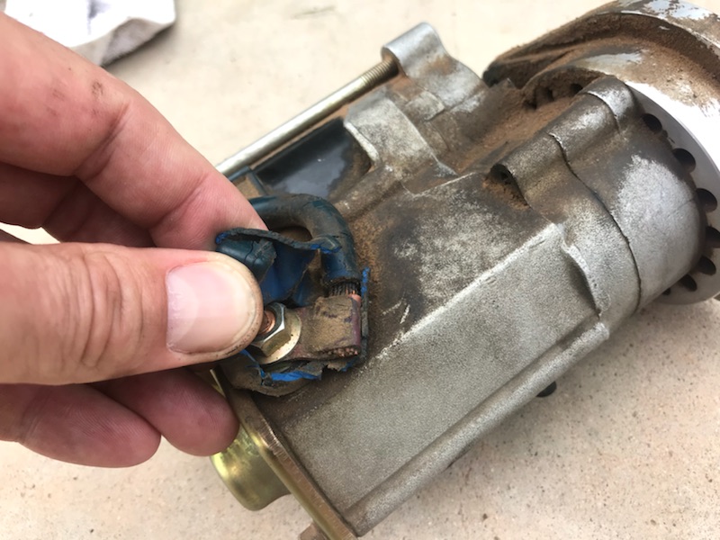

I could hear a loud grinding noise on start up. Same sound as trying to start a vehicle when it's already running, only mine wasn't, and it was grinding on every start.

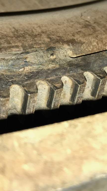

No visual damage or uneven wear on the flywheel

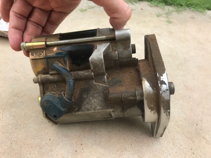

I noticed the wire housing which connects the solenoid to the starter motor was cracked and brittle
Wire was black

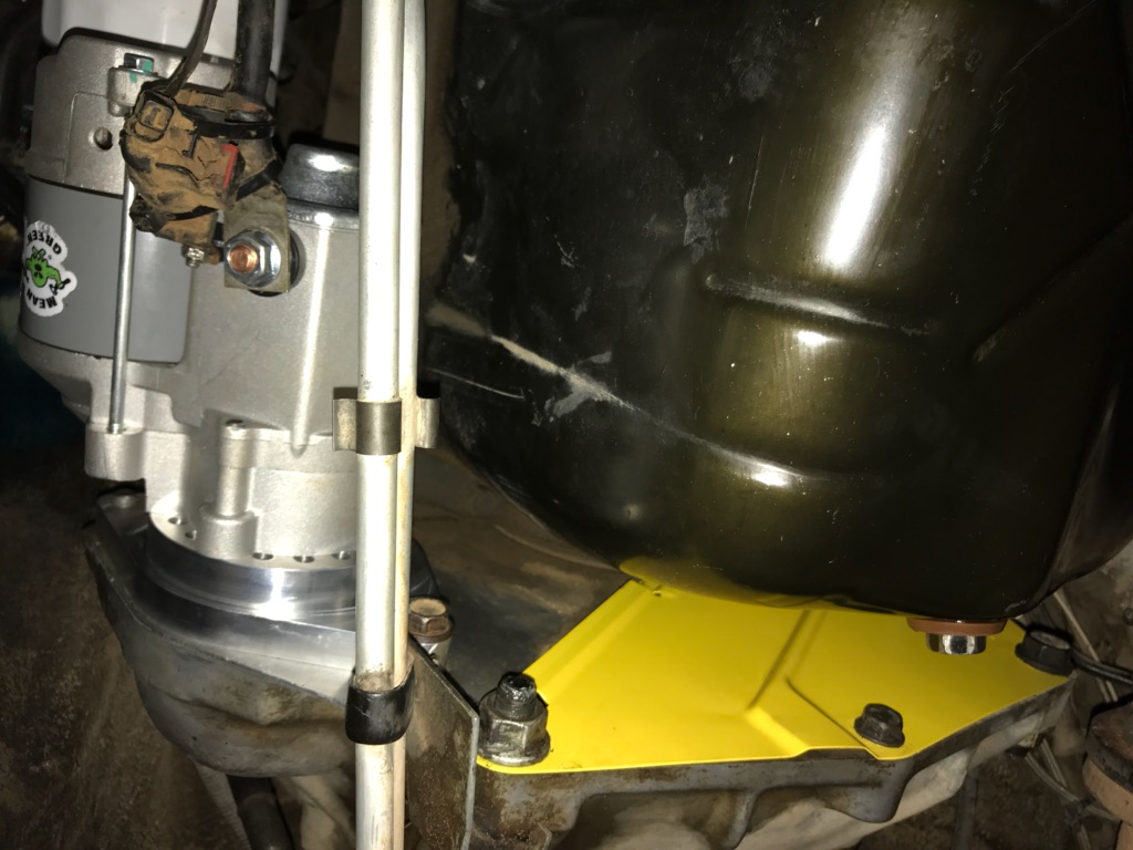

Inspection plate was covered in grease and dirt muck so I cleaned it with degreaser, a wire brush then painted it to match my brown dog motor mounts

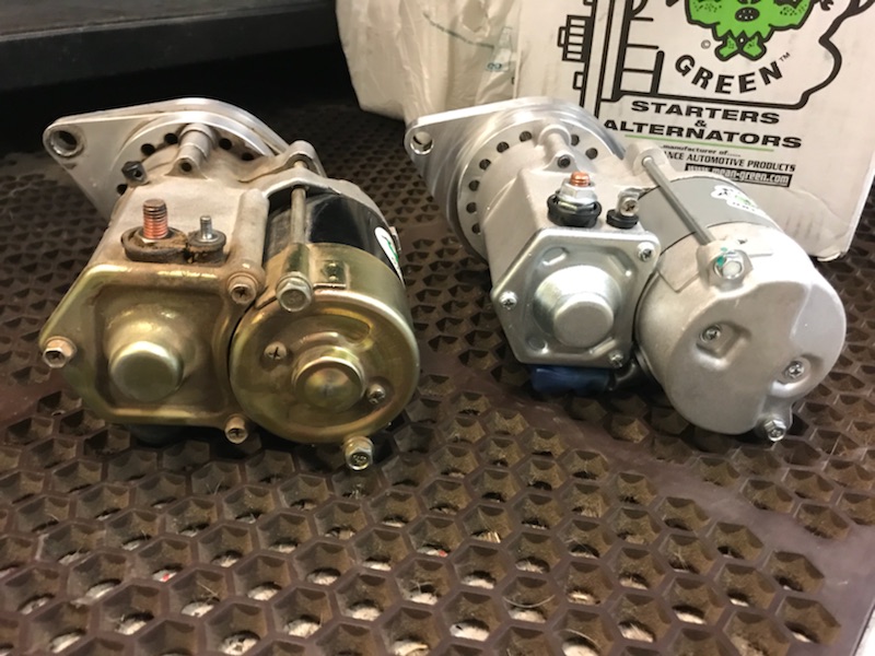

All complete and back in good working order
