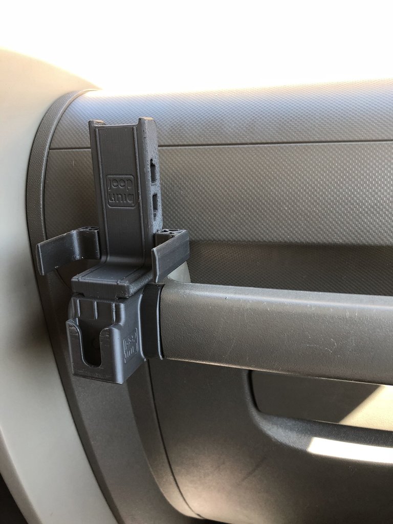

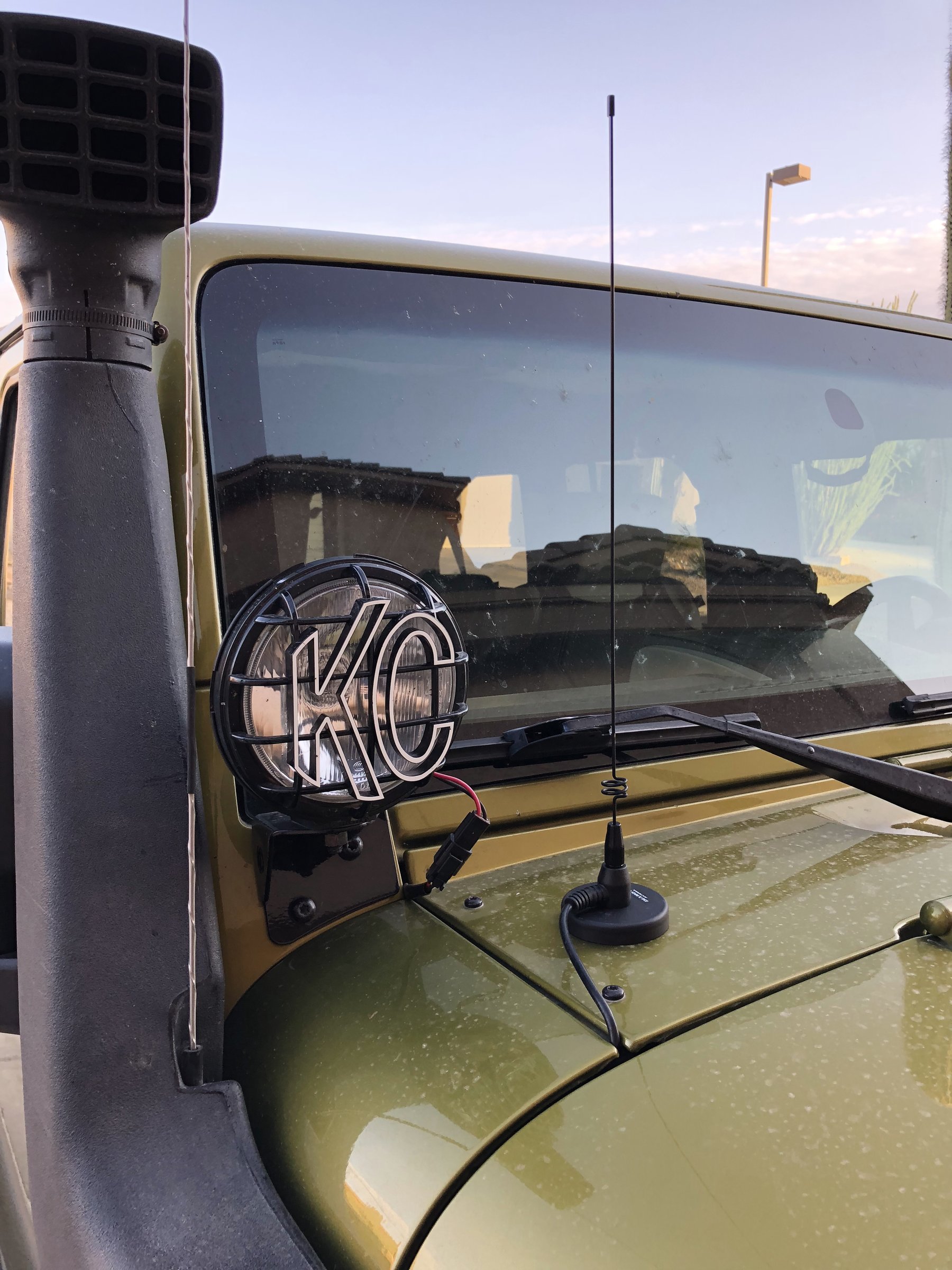

1) Handheld with external mag-mount antenna. Ham radios using FM transmission in the VHF (2m) and UHF (70cm) bands are highly effective at low powers. On my JK, I dropped a short mag-mount antenna (Diamond MR77S - SMA) on the cowl, ran the antenna wire through the firewall using a Jeep pre-made entry point under the cowl structure, and then let the antenna wire come out from under the dash to connect to a handheld radio (easily hidden if I take the radio with me. I then bought a JeepUniq dash mount that integrated into the passenger dash grab bar. That mount has a HT Radio clip and a microphone button holder. I started with a Kenwood D72a, have used a Yaesu FT2DR, and also a few cheep Baofengs. The antenna I bought terminated in an SMA connector compatible with the Kenwood and Yaesu HT radios. I used a SMA gender converter for the Baofengs as they just had to be different. I finished the setup with a microphone that is compatible with the handheld so the radio can stay attached to the JeepUniq base.
  • This setup requires no antenna tuning and "just works". I was able to talk to the White Tanks repeaters using a measly 5w from all the war over in east Scottsdale.

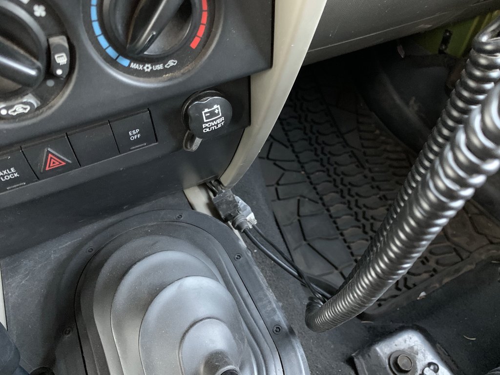

  • I never bothered with hard power as I found as little as I transmitted the battery lasted for days.
    • There are car-power-wire options for most HTs.
  • JeepUniq makes mounts for newer JKs and JL/JTs also.

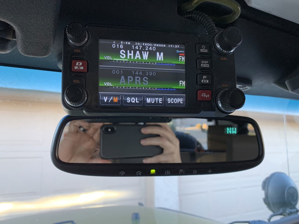

  • The head and body are separate
  • Full color, easy-to-read compact display
  • Display can show a interesting radio transmission and GPS data
  • Head/display and mic based controls are fairly easy to use
For an antenna, I put together a solid fixed base mount close to the driver so that it was easy to reach out and fold down the antenna if need for tight brush and garages. I looked at different ways to mount considering
  • Location
    • Ease of driver reach
    • Exposure of wire between the body seam and the antenna base
  • Solidness of the mount (ability to withstand brush abuse)
    • Solid for the antenna itself, prevent tear off or severe vibration
    • Solid to prevent damage to the vehicle body where the mount attaches
  • A base setup that support different antenna options without much effort/work
I started with my now "mid-sized" fold-able antenna, a Diamond NR770HB. You can grab the antenna near the base, pull up and fold it over (full 90 degrees). I eventually switched to a Comet SS-680SB spring base (self-flexing). It is shorter but for 90% of my use cases effective enough in range. It is rated to the mobile's full 50w. It also goes into most garages without issue.

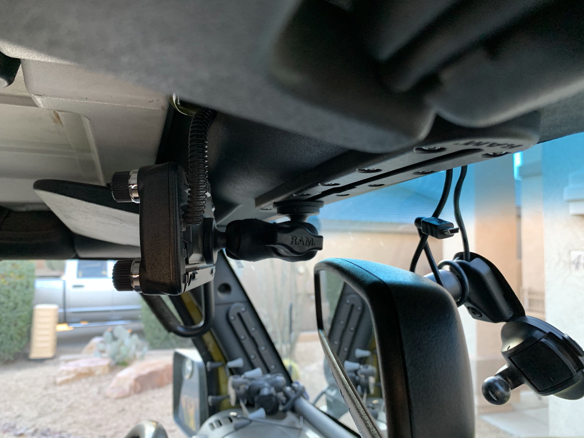

  • I got creative with the head. I found a black RAM slide mount base with adjustable 1" mount balls. I use #10 black bolts to attach the slide to the trim piece above the rear-view mirror and between the visors  I crafted a RAM ball mount to and for the radio head and then attached that ball on the slide. Once everything is tightened down it is solid. But easy to adjust later
  • I originally used the old JeepUniq dash mount to hold the mic. But since I have two mics, this had its limits.
  • I eventually found a metal bracket that went into the radio tower trim seam and held in by the radio mount bolts. To that I attached a mic cradle.
    • Now the mic I am actively using is cradled on the car radio tower and the other rests in the JeepUniq cradle.
  • For the antenna base I settled on the KC A-Pillar light bracket for side mounted lights.
    • I drilled out the light bolt hole to handle a UHF base.
    • I then selected an antenna base with a very thin RG188 pigtail that runs/hides easily under the forward A-pillar light mount and slips right into the cowl seam where it converts to standard coax. The COMET-NCG CK-3M5 if I remember correctly.
