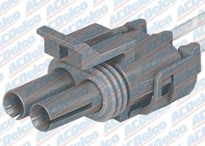

It wasn't the "old guy", not the transfer case guru anyway. Finally got my jeep back last night and (drum roll) so far so good. Speedometer works correctly and the "part time" indicator light comes on as it should. Turns out the pigtail i bought from Amazon for the part time light wasn't necessary so if anyone else plans to do this swap i have an extra one for sale un-opened:
