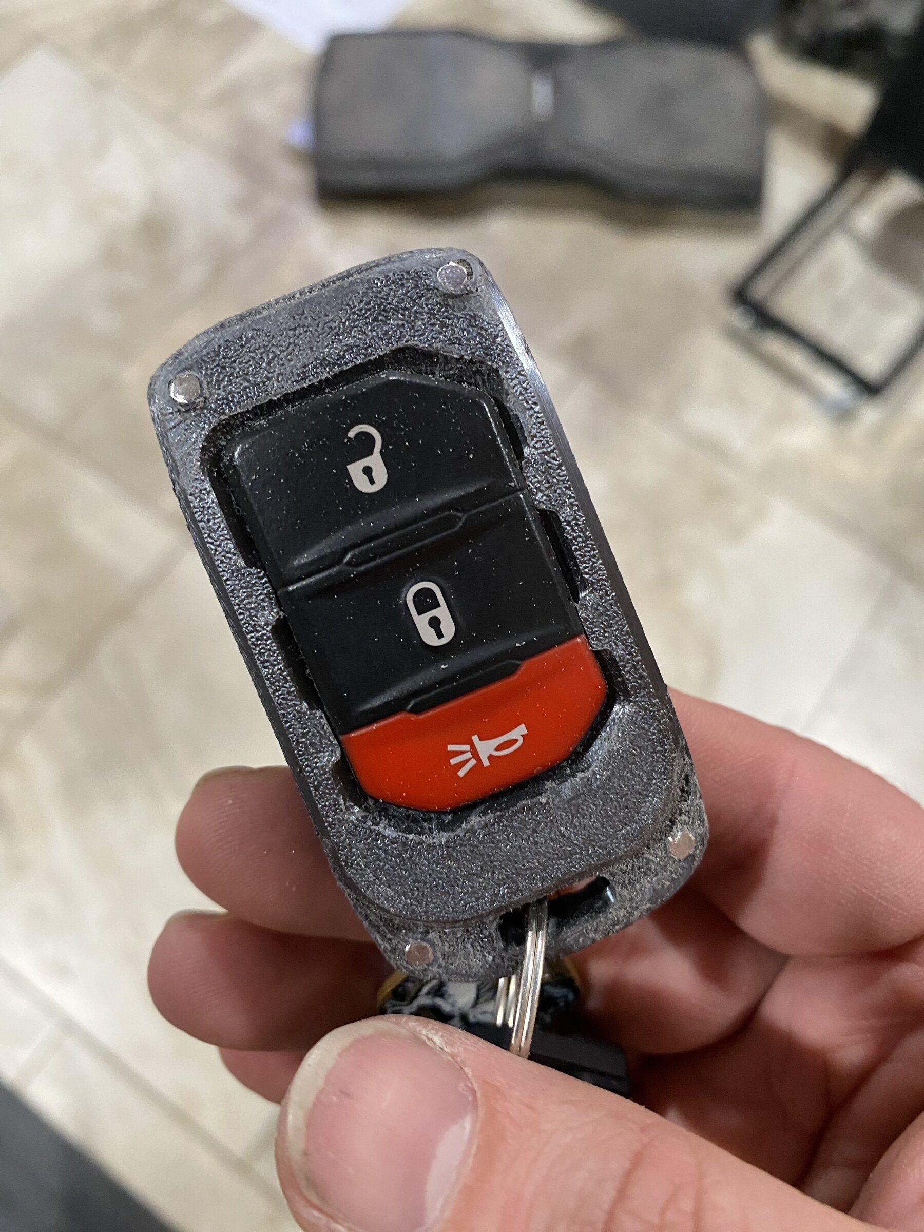

ChubbyUnicornAZ 31 Posted April 30, 2024 (edited) Not really to my rig but for my rig. I didn’t like the big clunky key fob so I made my own much smaller version. I need to update my build threads because so much has happened. Edited April 30, 2024 by ChubbyUnicornAZ converted .heic to .jpg 2 1 Share this post Link to post Share on other sites

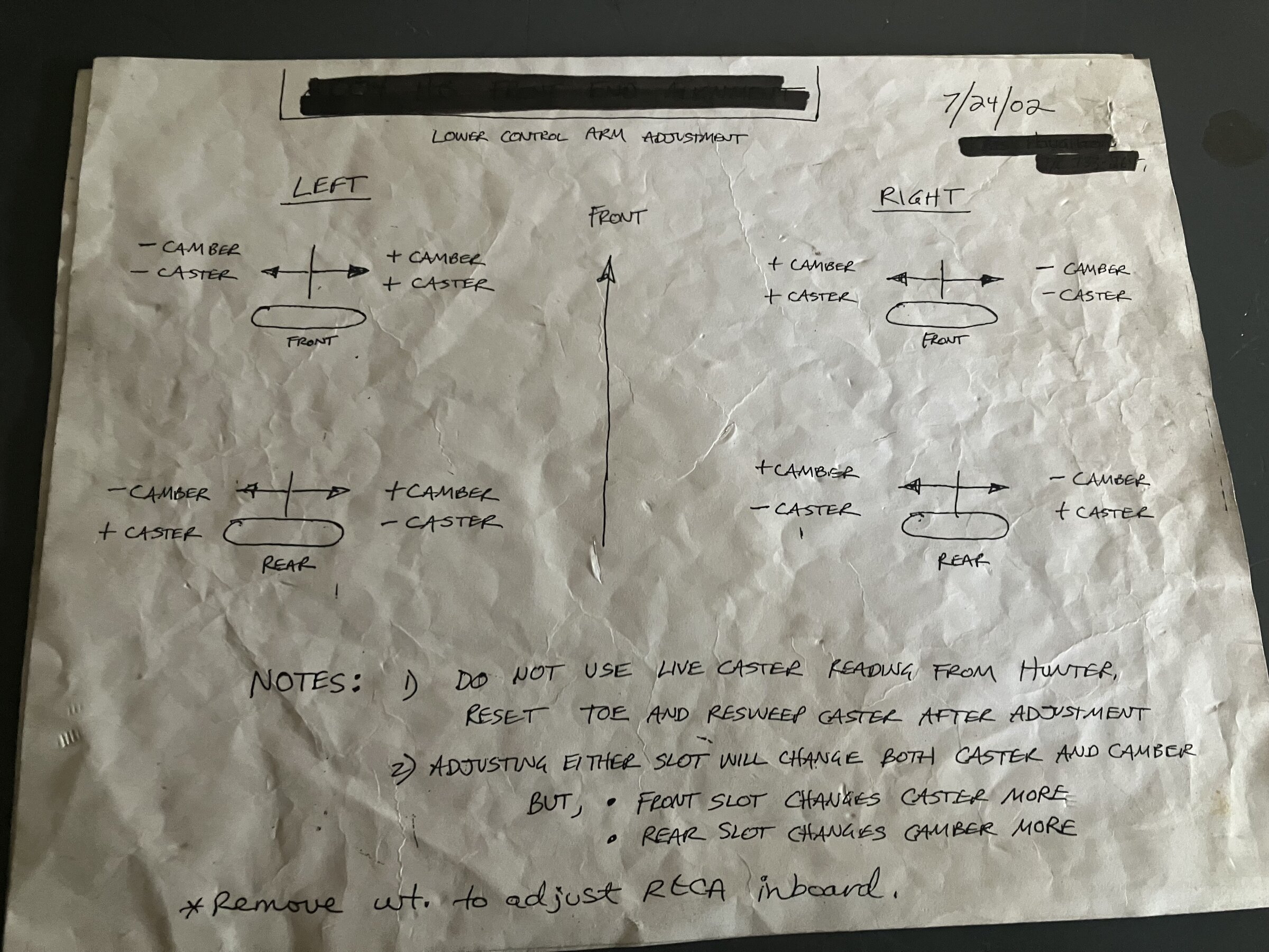

jgaz 750 Posted July 3, 2024 (edited) 9 hours ago, theksmith said: over the last couple months, Gadget developed a mild shimmy when hitting certain bumps while turning. had tires rotated and balanced to no avail. i was running about 1/16" of toe-in over a 2ft span (whatever degrees that works out to) - so i tried a little more, but that didn't help either. so i tried a little less, a half turn on my Synergy tie-rod adjuster back from my original starting point, and that seemed to do the trick! so, anyone else keep crib notes on their workbench? :) Not on my workbench but I’ve always used a notebook at work that was kept under the lid of my top box. This is a “cheat sheet” I made for aligning MOPAR vehicles with adjustable LCAs. I think this was originally made when the Durango (HB) changed models in about 2002. I struggled with the KJ Jeeps before this. So much of my alignment experience was with adjustable UCAs starting with my GM dealership days in the 70s and 80s. Ive also done dozens and dozens of Dodge pickups that had adjustable upper. I just knew intuitively how moving the front or rear upper bushing was going to change the alignment. I never seemed to grasp in my head how movement of the lower affected caster and camber. This sheet was under the vehicle with me. The ovals labeled Front and Rear represent the LCA bushings. Edited July 3, 2024 by theksmith 2 1 Share this post Link to post Share on other sites

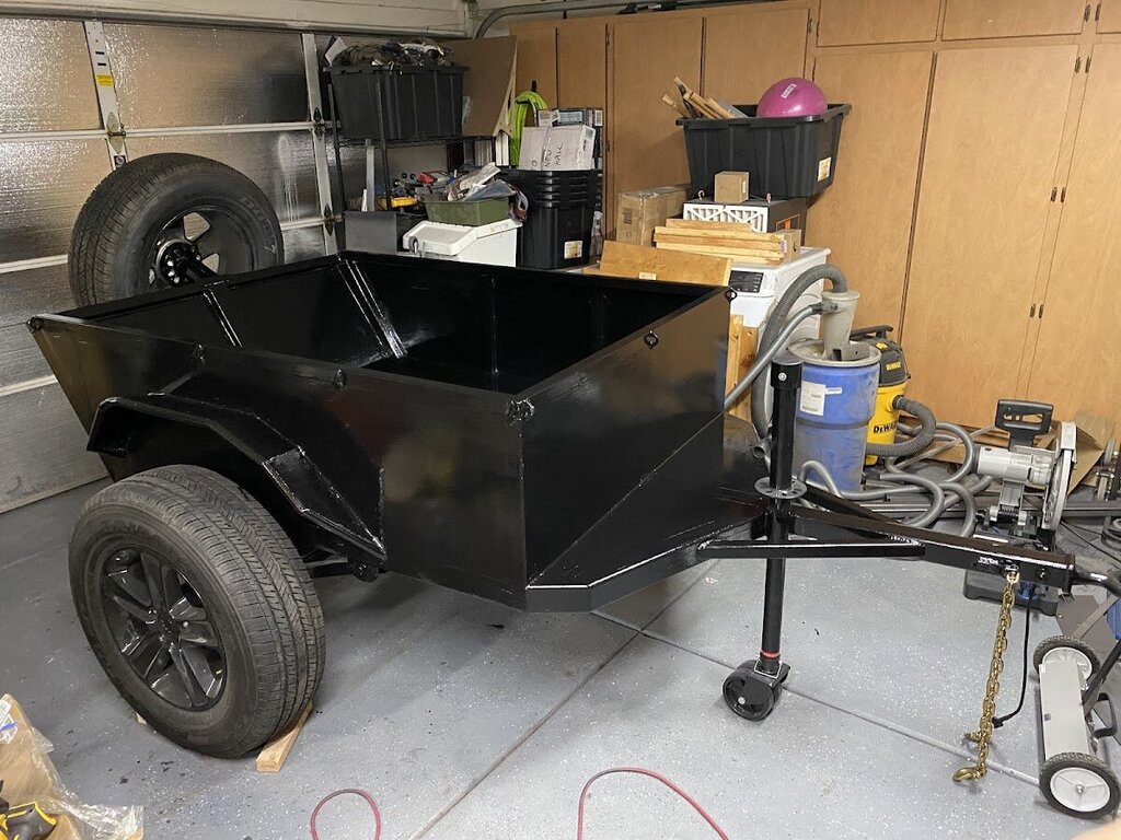

ChubbyUnicornAZ 31 Posted August 10, 2024 (edited) Built a little (54" x 72" box) offroad trailer over the past two weekends. Got it painted yesterday and this morning. Independent suspension, used my original Jeeps wheels and tires. Made fender flares to match my Jeep. This thing is a tank. Edited August 10, 2024 by ChubbyUnicornAZ 3 1 1 Share this post Link to post Share on other sites
ob1jeeper 849 Posted August 10, 2024 2 hours ago, ChubbyUnicornAZ said: Built a little (54" x 72" box) offroad trailer over the past two weekends. Got it painted yesterday and this morning. Independent suspension, used my original Jeeps wheels and tires. Make fender flares to match my Jeep. This thing is a tank. Looks pretty stout for sure... Well done... ;) Share this post Link to post Share on other sites
